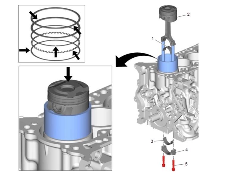

Good morning,
I attached a picture of the gap locations for you.
The ring gap should be set at 90 degrees from each other.
