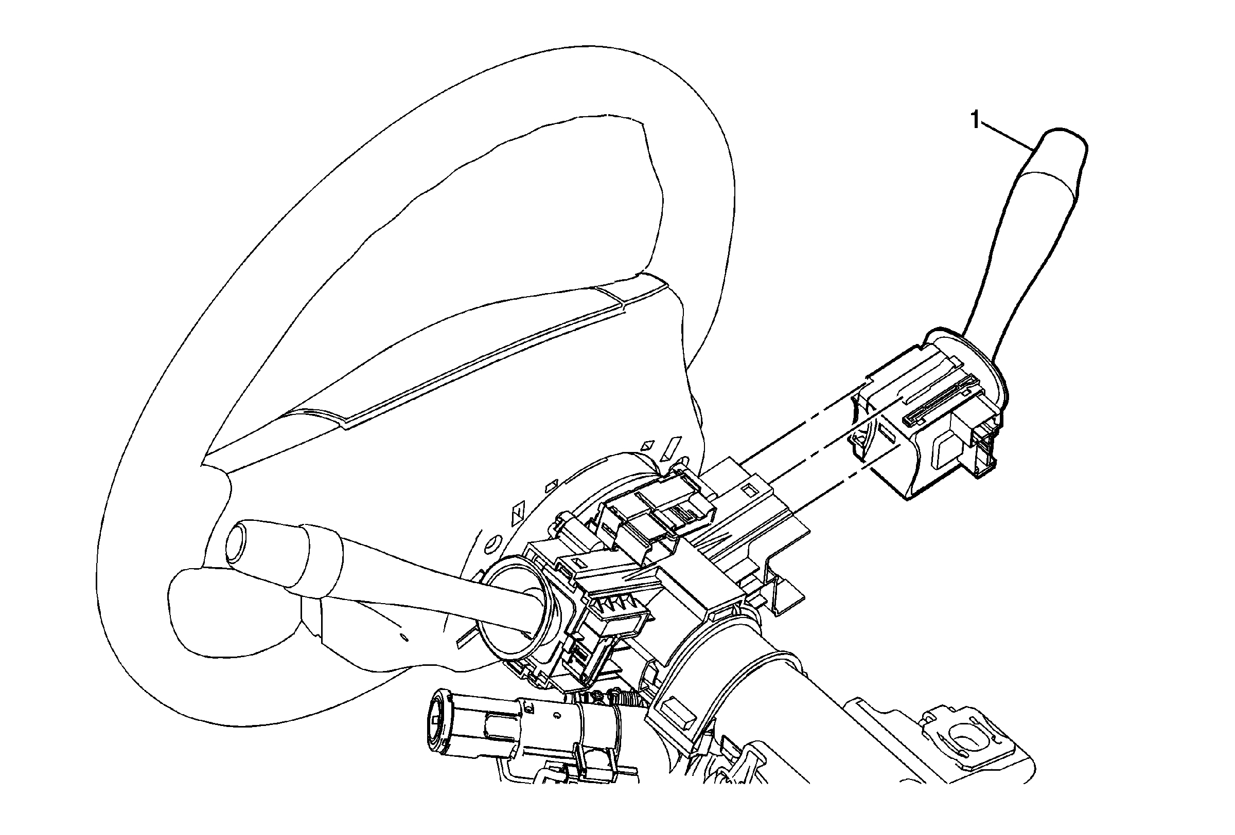

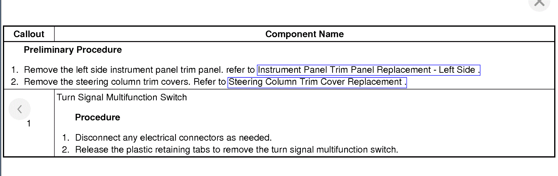

The three flashes are achieved by pressing the lever briefly and releasing. Does it do it when the lever clicks and holds the lever? If it does, then it sounds like the switch itself is bad.
Let me know. If you determine the switch is bad, pictures 1 and 2 explain how it's replaced.

Honestly, it sounds like the multi function switch is failing internally. I suspect something is loose causing it to actuate 3 times twice.
