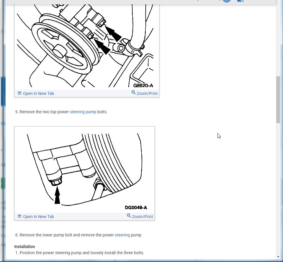

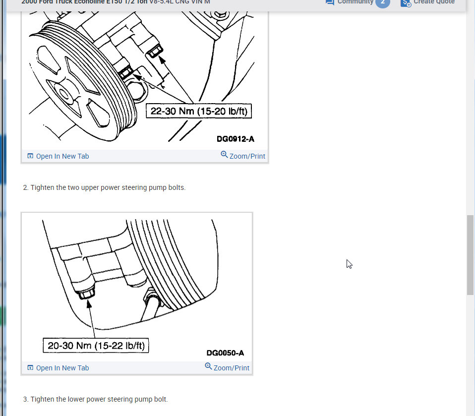

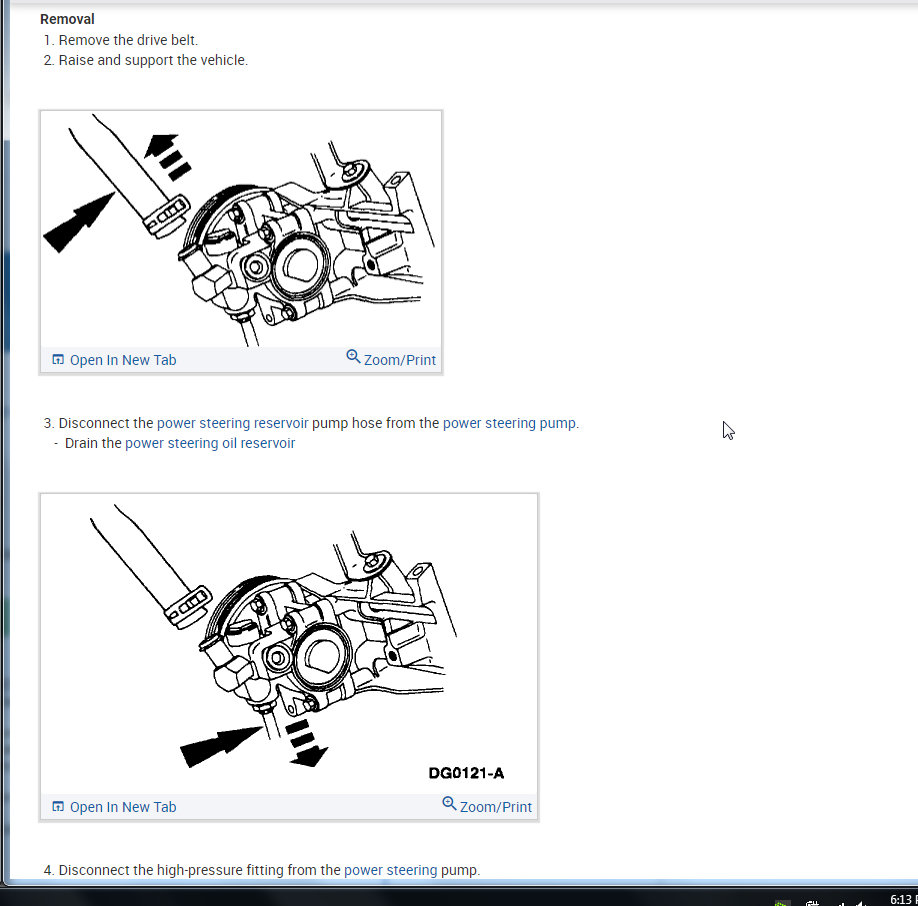

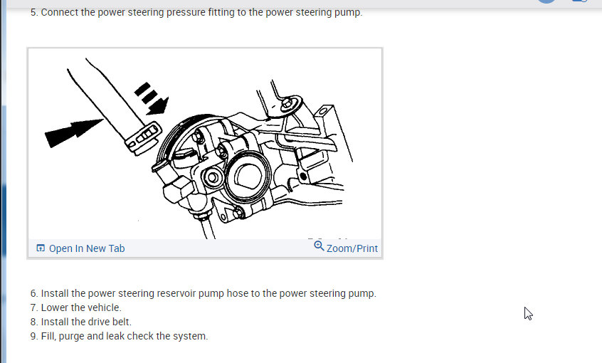

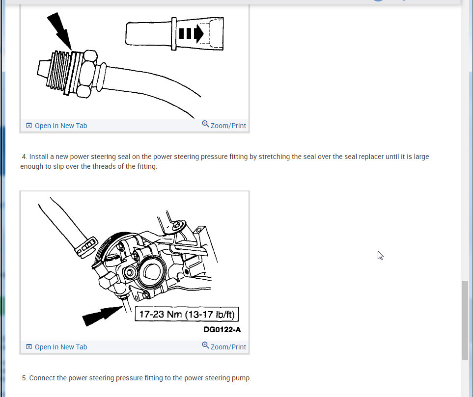

If there is no vacuum leak then I suspect the power steering pump is binding in that direction which is adding stress to the engine and pulling the RPM down. If this is the case, it is unlikely the engine will stall unless there is another issue.
https://www.2carpros.com/articles/power-steering-problems
https://www.2carpros.com/articles/how-to-replace-a-power-steering-pump
Attached below is the process to replace the pump. Please review this material and we can go from there. Thanks
