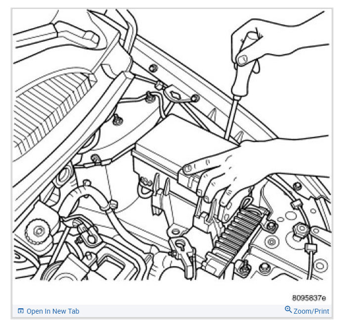

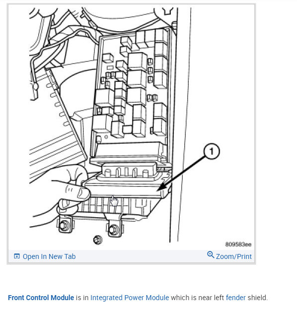

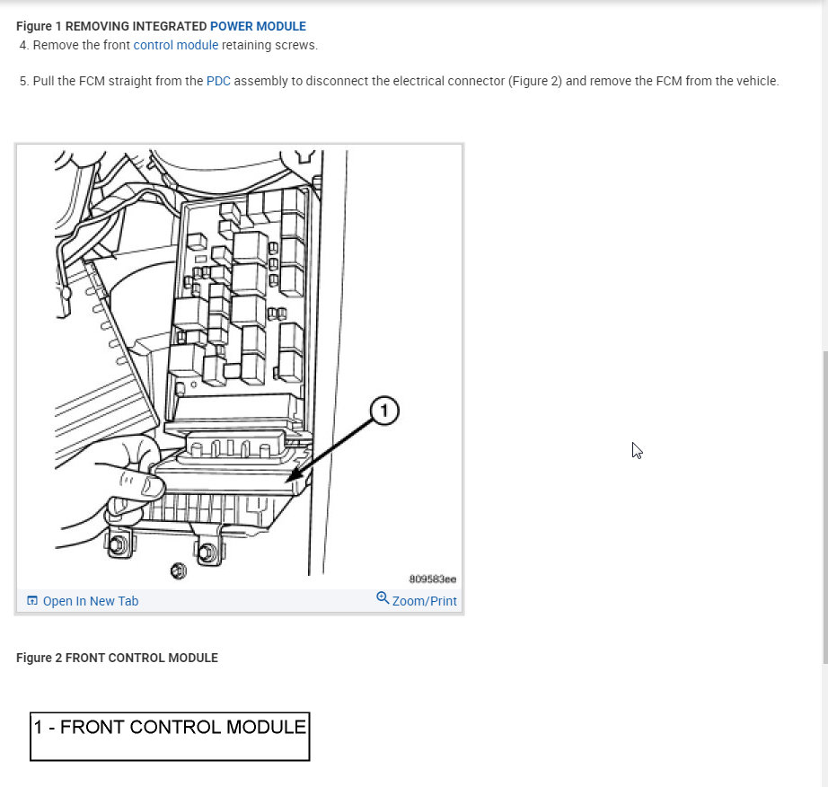

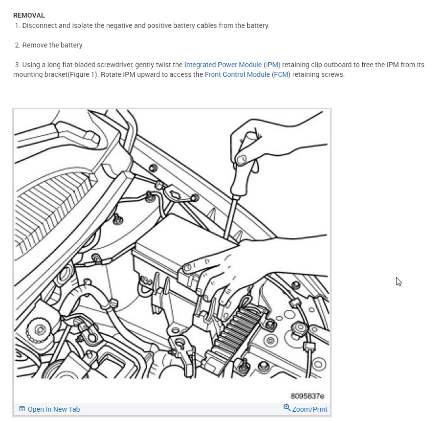

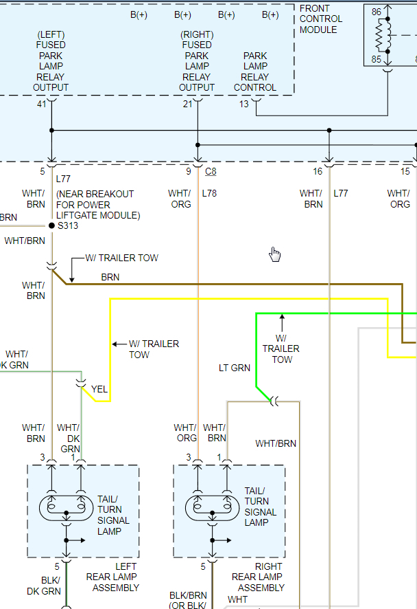

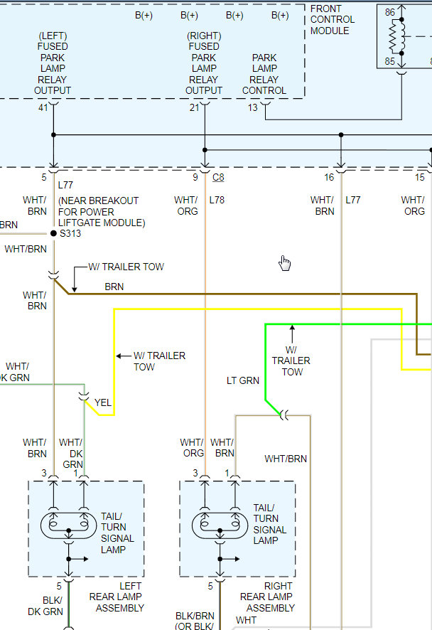

More than likely this is an issue in the front control module but it could also be a wiring issue. So to check this properly, we need to measure voltage coming out of the FCM to see if you have any. If you don't have voltage then it could be the fuse shown. If not, then replace the FCM.
Let me know if you have questions because this is more complicated diagnosis.
