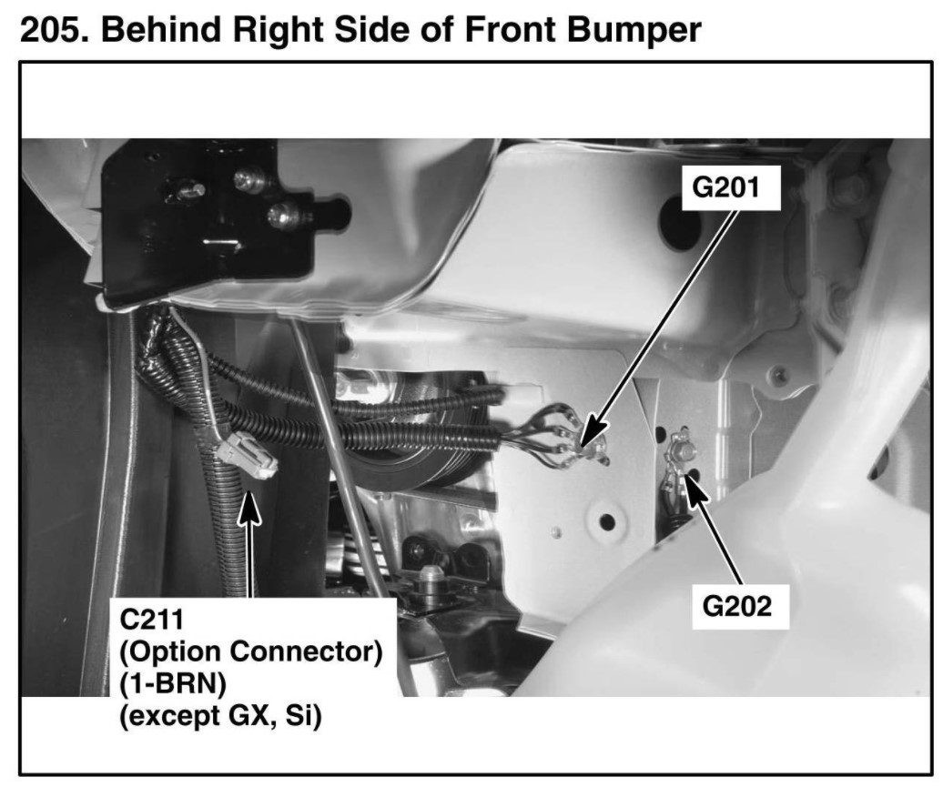

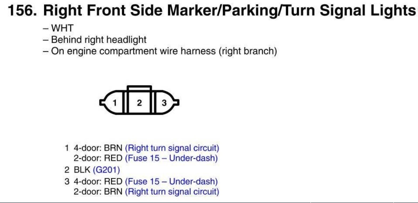

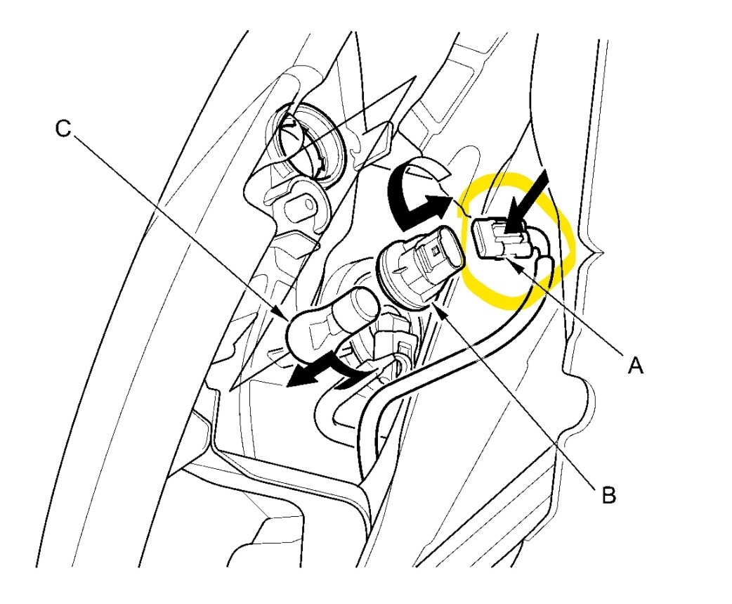

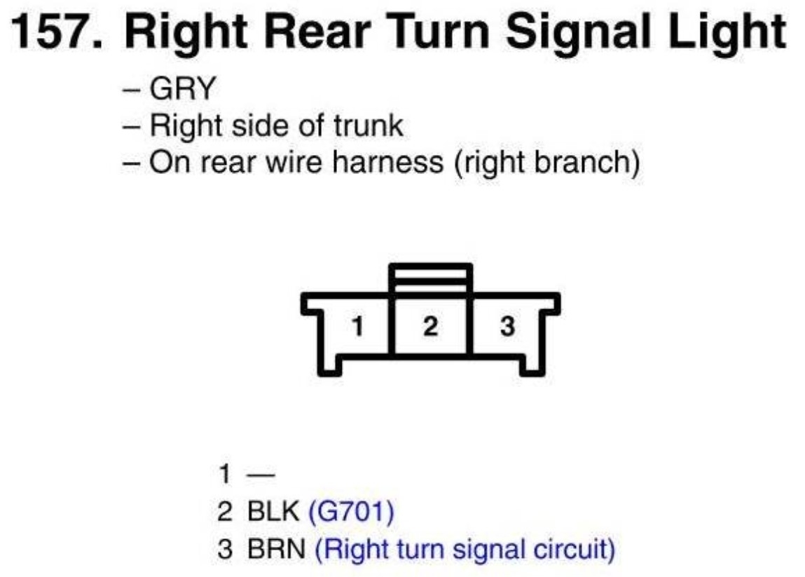

The right side turn indicators are flashing fast, both front and rear work. I replaced bulbs (OEM) and checked for corrosion in the sockets (contacts are clean and shiny) verified the ground in the socket is making contact with the bulb.
Still flashing fast on the right side. The driver's side is normal speed. The hazards flash normally on both sides.
It seems the new bulbs on the passenger side are brighter than the driver's side.
