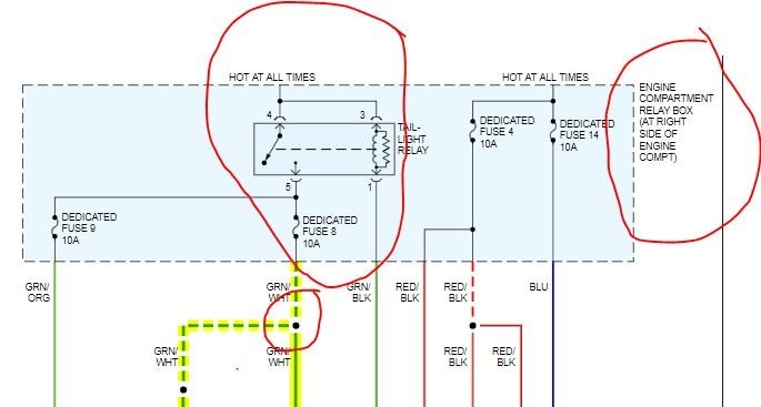

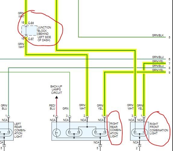

There are a couple things we need to check. First, since it worked when the new switch was installed, my first suspect is there is a bad connection at the switch. What I want you to do is remove the switch and confirm the pins in the plug are not corroded, pushed in, or damaged in any way.
Next, I attached two pics. I circled the tail light relay as well as the fuse and splices that tie the front and rear light together. Check those things as well.
