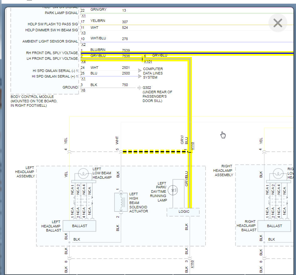

The only thing that would really make sense with this is the BCM is shutting them down. So let's monitor the voltage from the BCM to one of the head lamps on the wire highlighted below. Clearly you will have voltage on the signal wire from the BCM when they are working but I suspect this voltage will go away and if it does, then they are being commanded off. If that is the case, the I suspect there is a signal issue that is causing the BCM to shut them off.
Here is a guide that will help doing this:
Just to be clear, these were not doing this until they were changed? Also, did you change to LED bulbs or something else? Can you provide the brand for these as well?

Okay. I think they are correct that there is an issue with the BCM but I am concerned that one of these lights is causing the driver in the BCM to fail or ground when it should not.
Clearly the best test would be to change the lights back one at a time and see if the issue continues until one of them is replaced.
