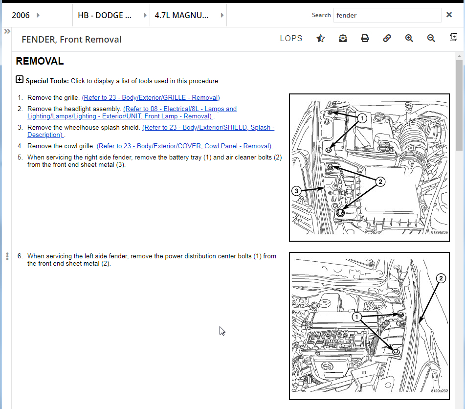

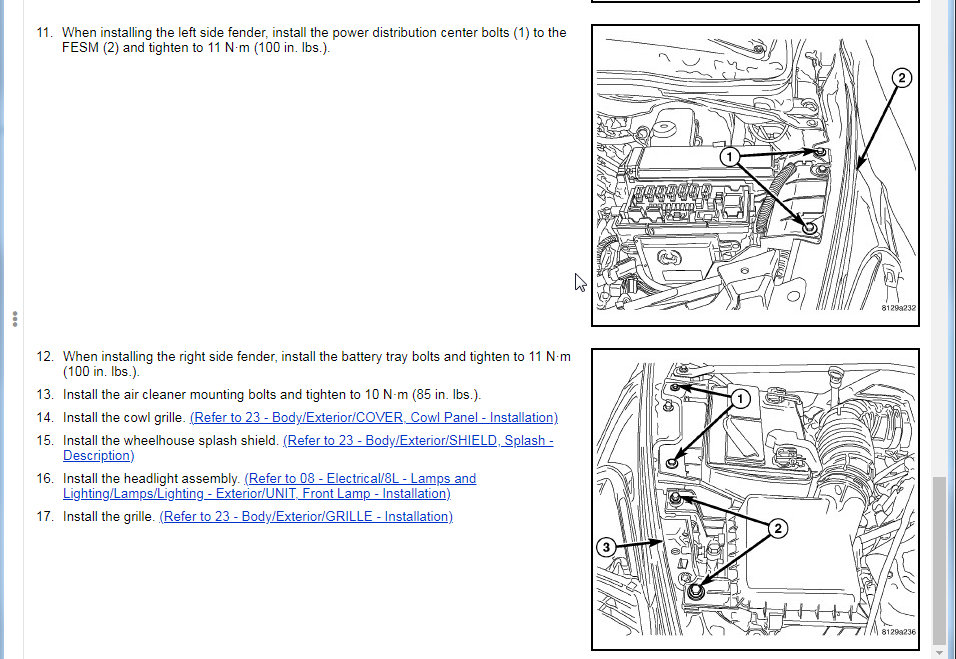

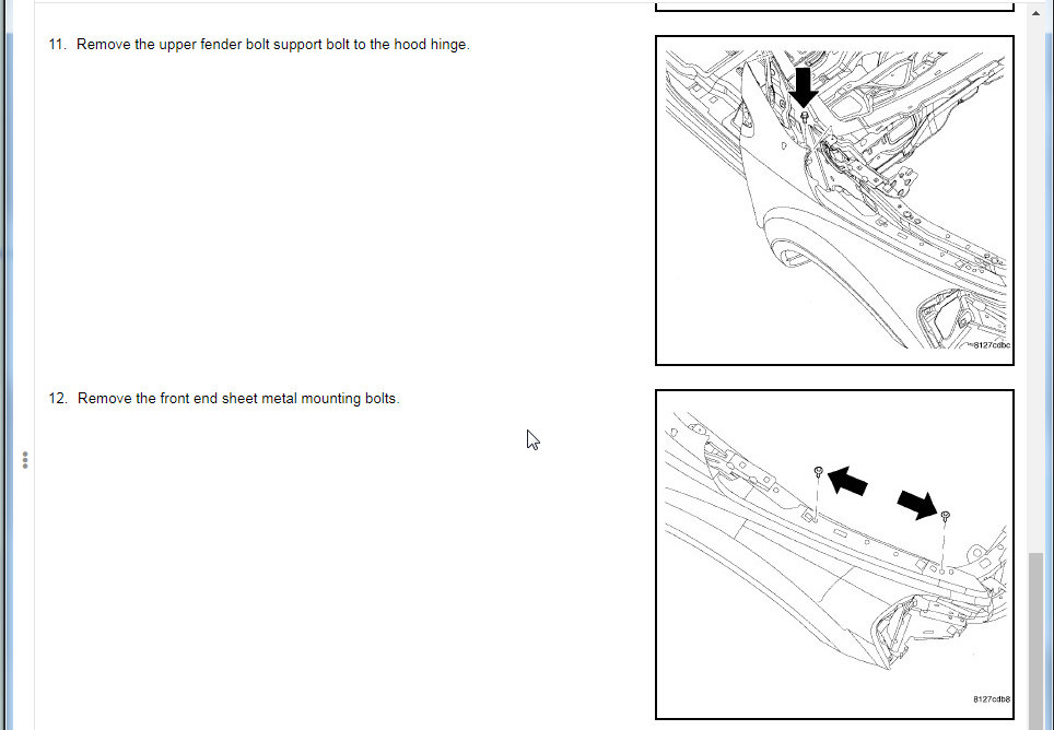

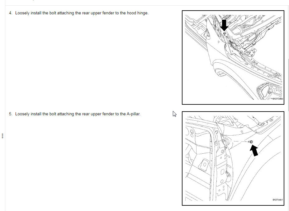

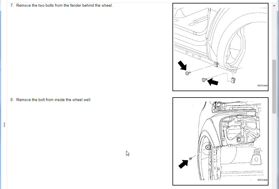

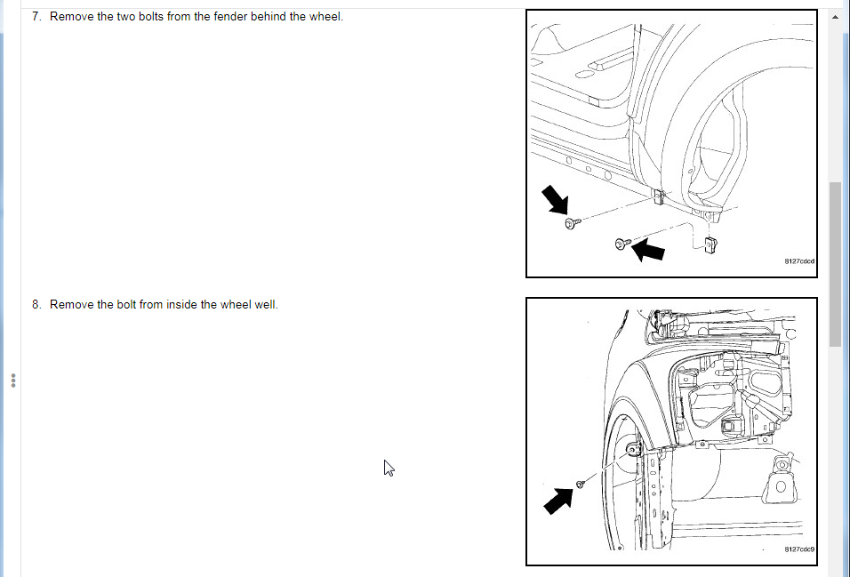

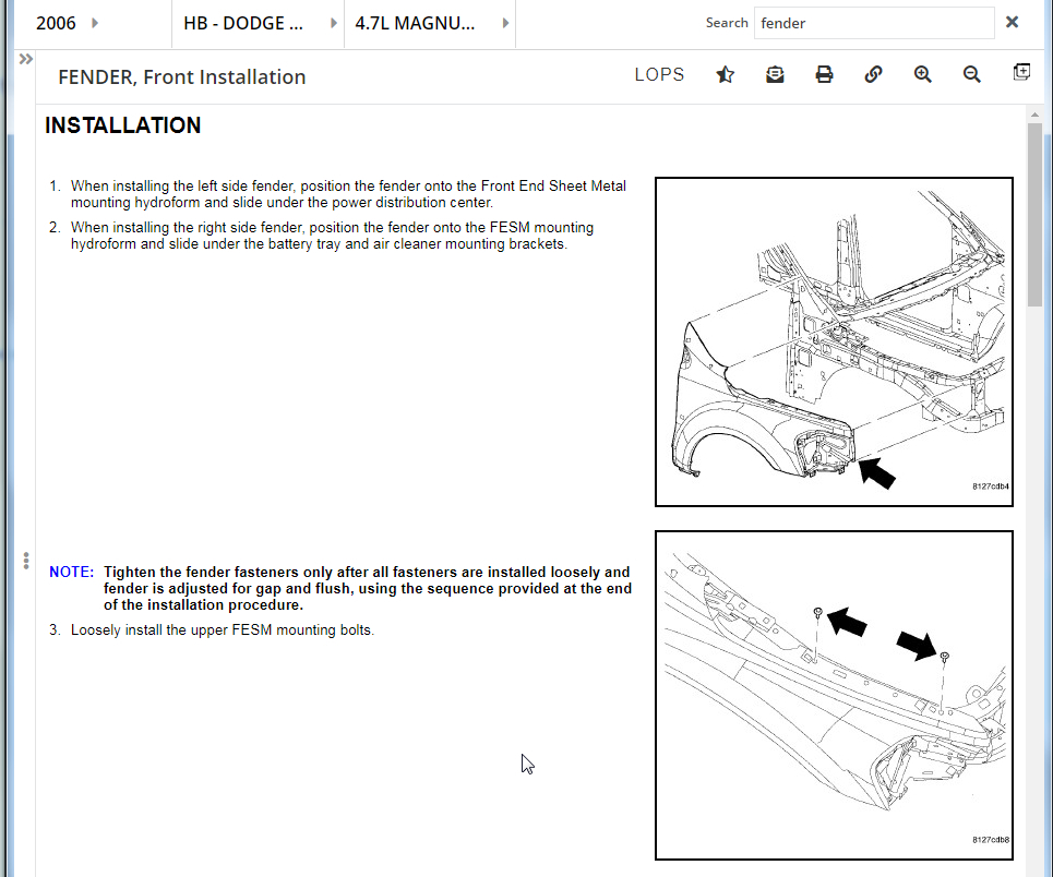

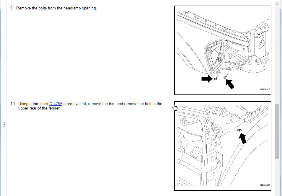

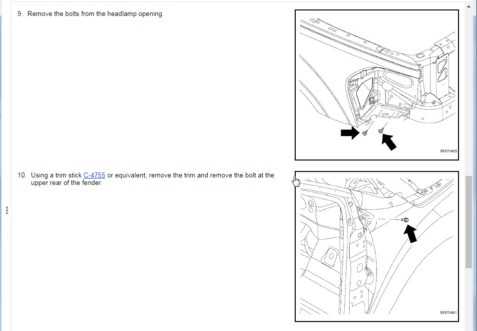

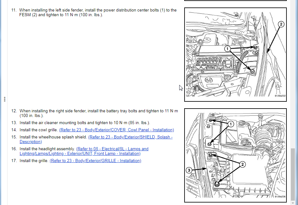

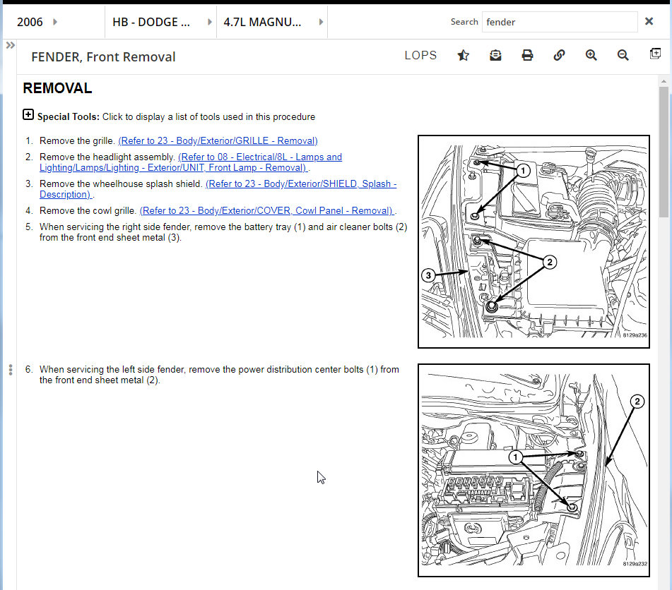

my vehicle was in a hit and run. right side fender has to be replaced. how do i remove the screws behind the runner. i believe it's two or how many are there?
Feb 25, 2021 at 3:11 AM

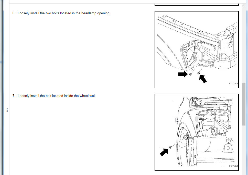

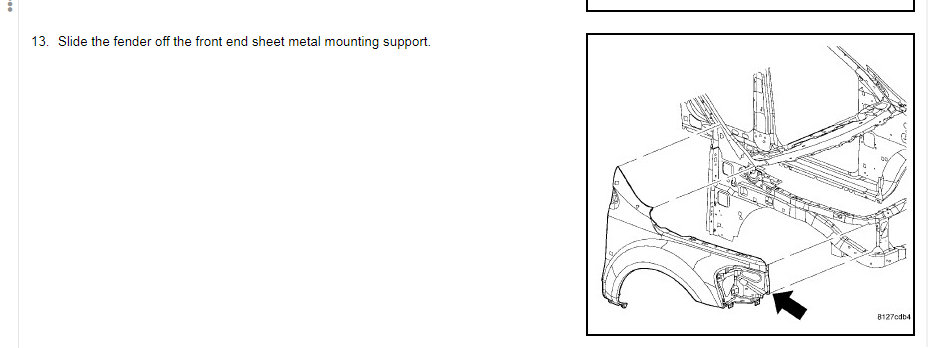

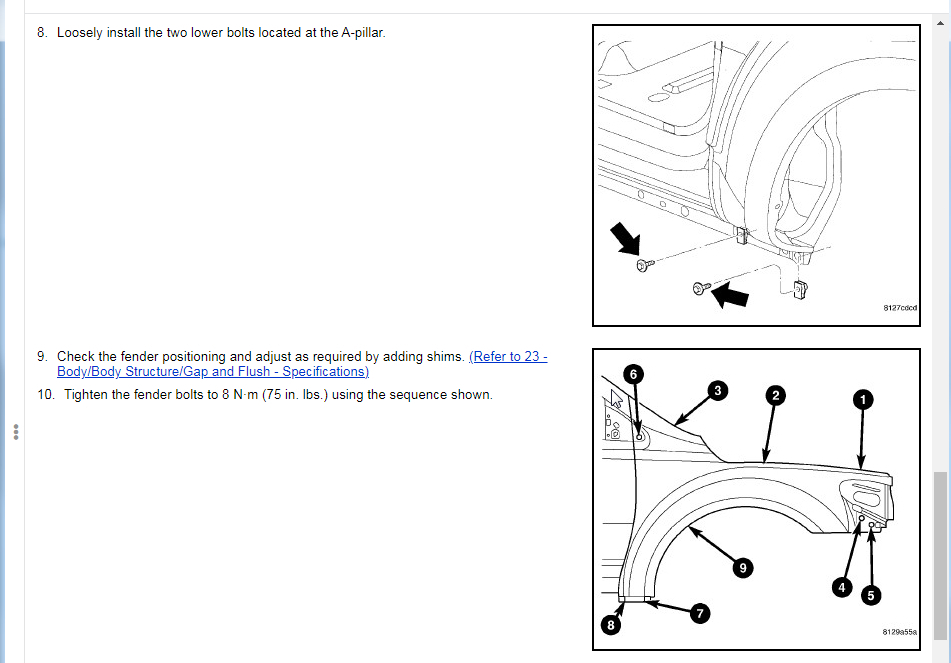

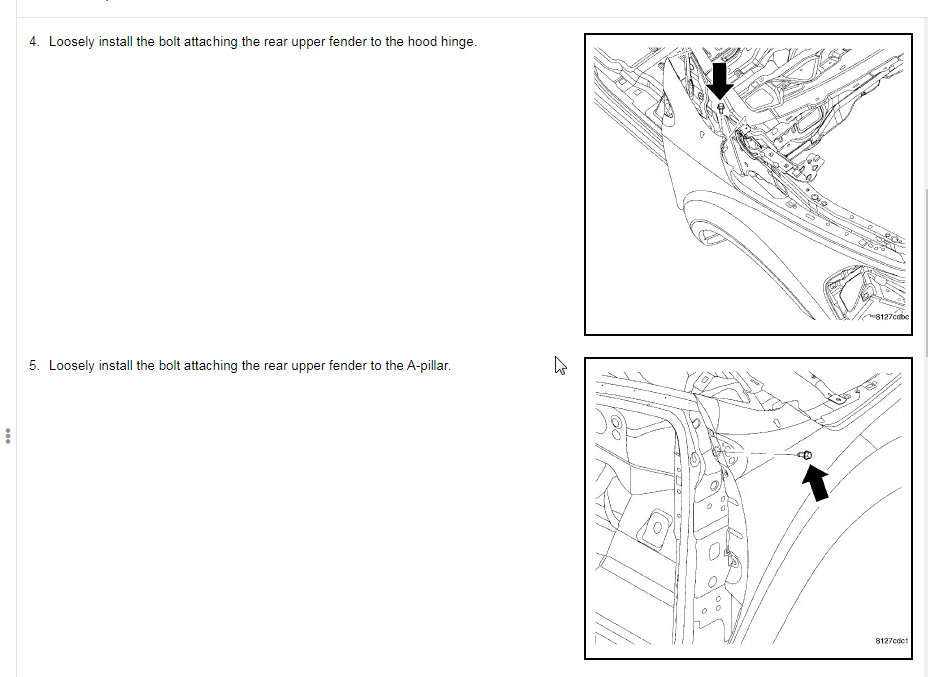

Sorry to hear that. I am attaching the process to remove and install the fender on this vehicle. Check out the diagrams (Below). Please let us know if you need anything else to get the problem fixed. Let us know if you have other questions on this. Thanks.

The two screws is behind the runner. do I have to take the runner off to take the right fender off?
