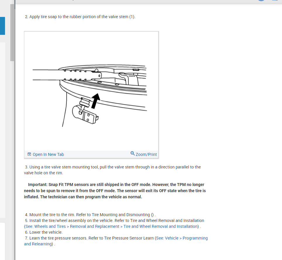

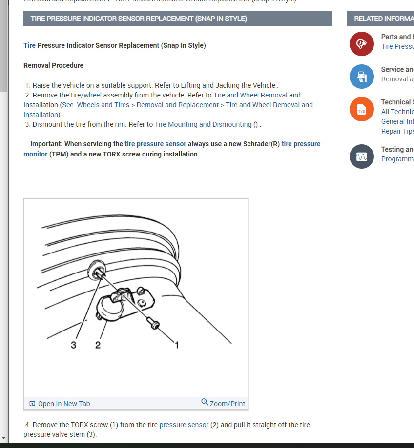

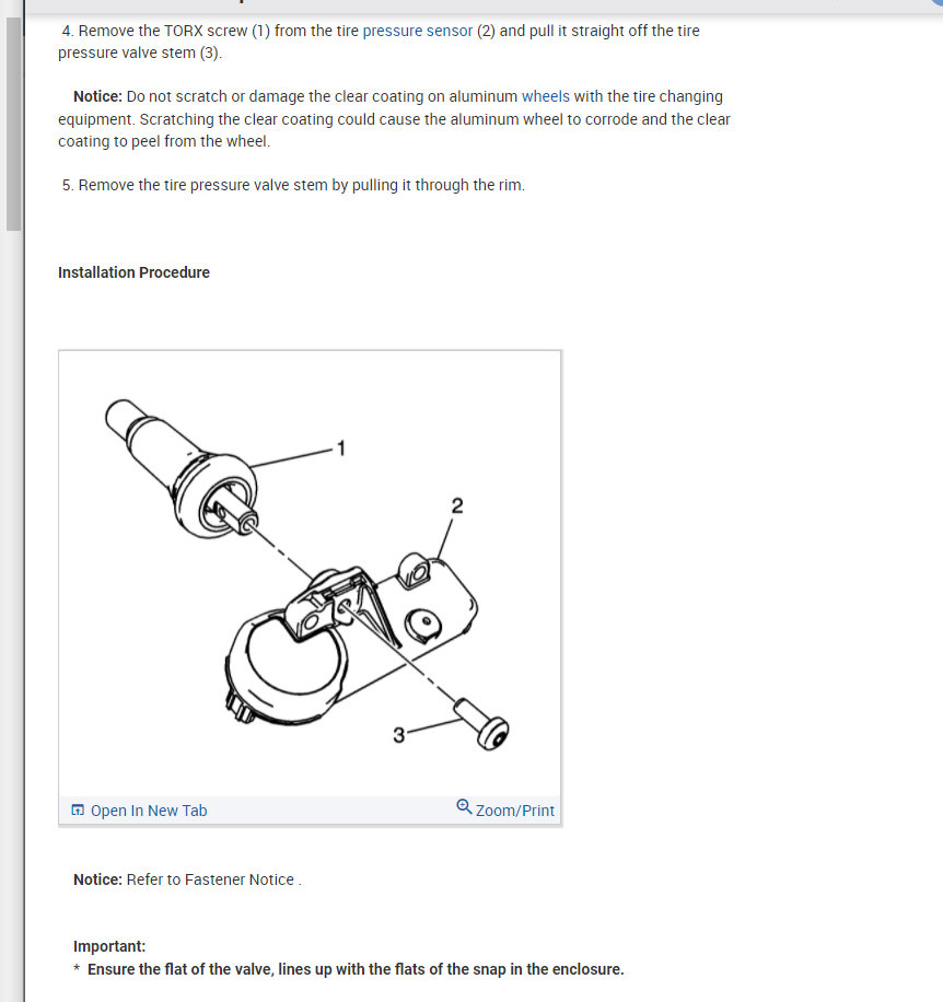

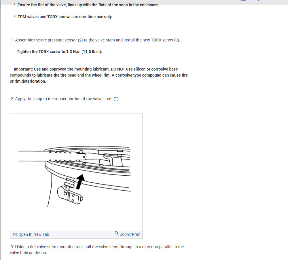

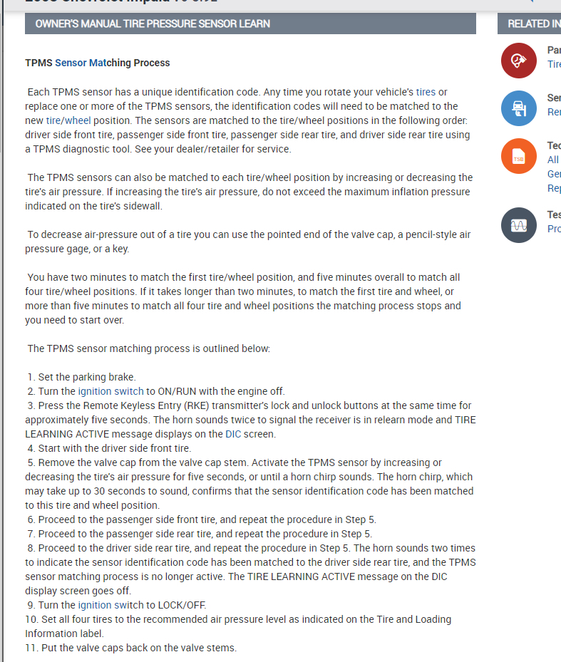

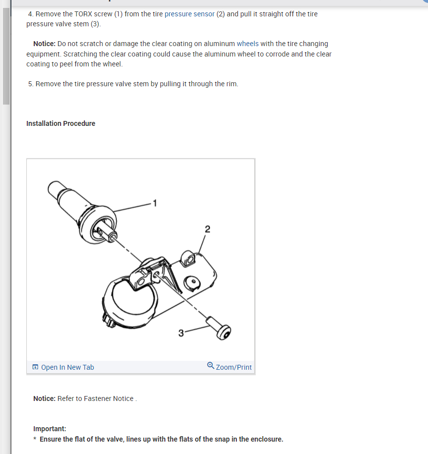

I attached the info below on how to relearn the sensors. Let's start with this and then we need to replace the sensor if that does not solve it.
Just keep in mind that after you learn the sensors, you will need to go drive the vehicle over 30 MPH to see if it picks up the sensor.
If not, then we need to replace it. I would make sure you use an OEM sensor as aftermarket sensors have all sorts of compatibility issues.
Please run through this and let us know if you have questions.
