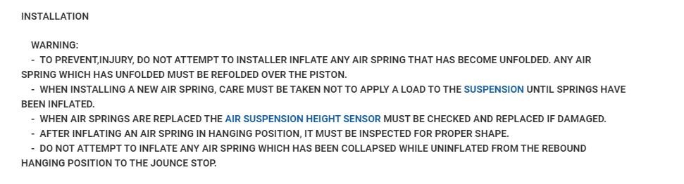

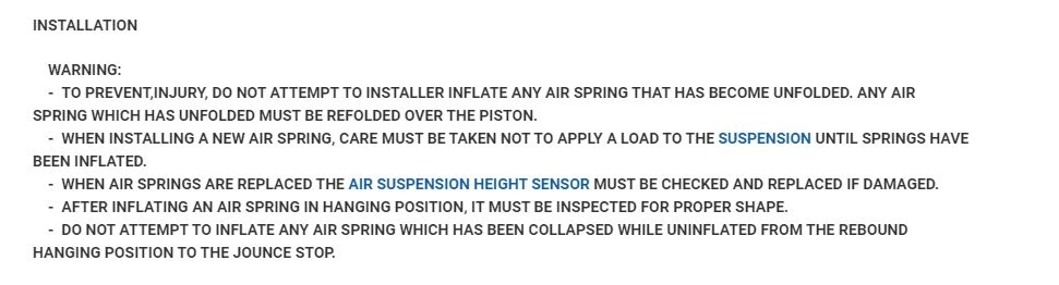

Did you drop the car all the way to the ground and then start it up? I have seen where the bags are replaced and damaged when dropping it down and it hits the ground. The bag gets pinched and will not hold air.
