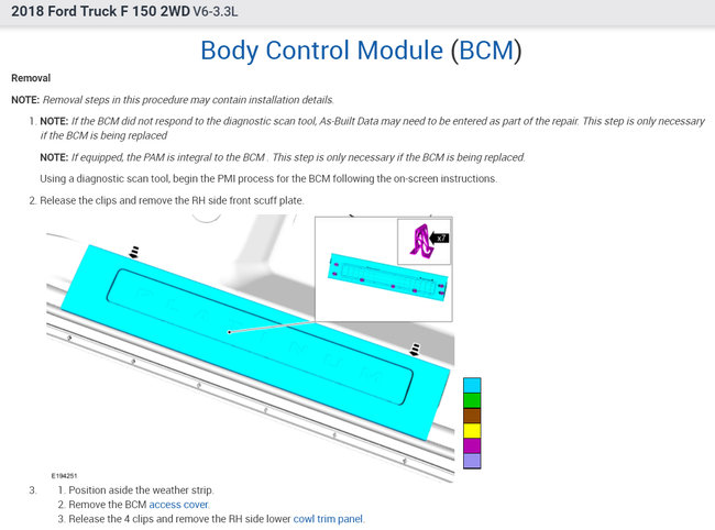

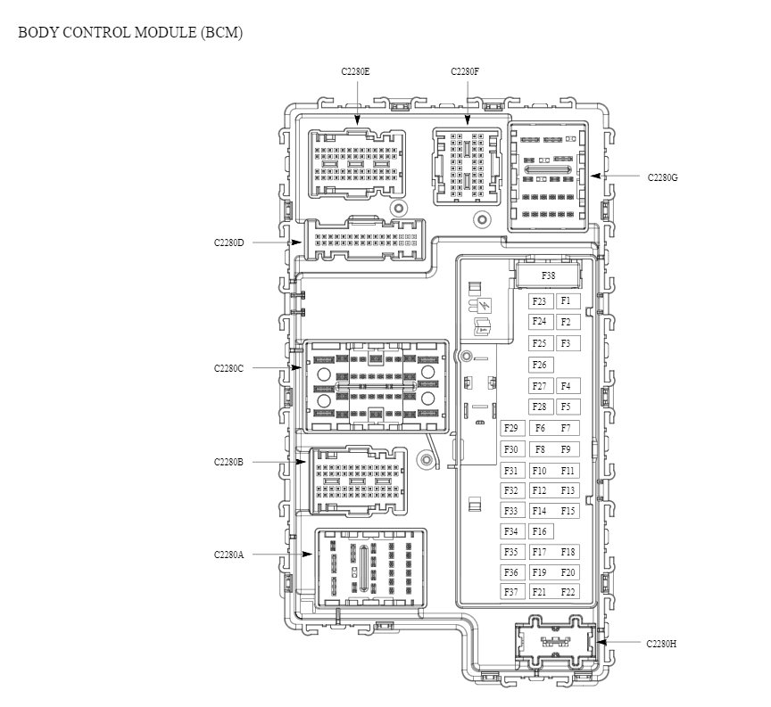

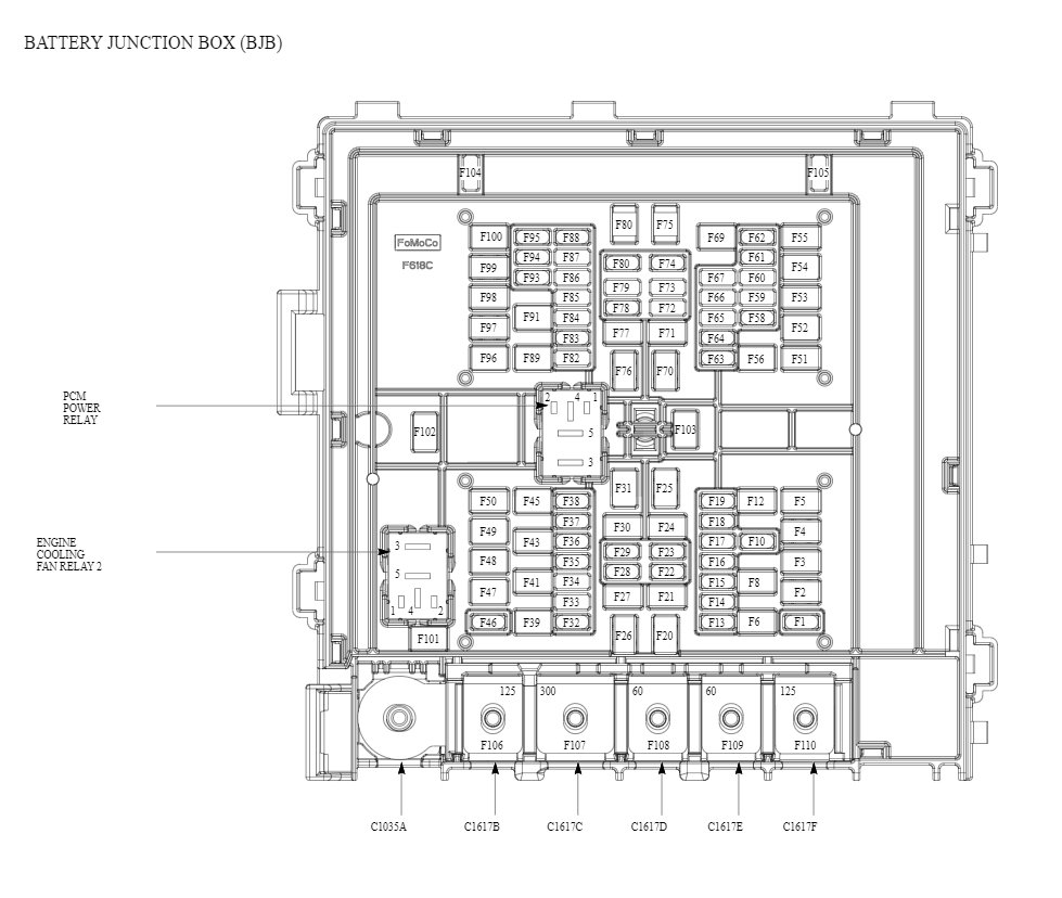

Let's check the fuses first, here is a guide to help you and the fuse (f20, f13 in the BCM lower right kick panel - #f76, f15, f61, f95 and f25 in the under-hood panel - locations in the diagrams below, this guide can help you as well.

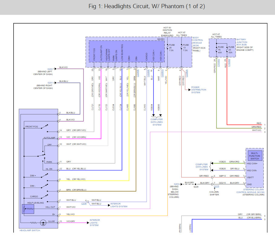

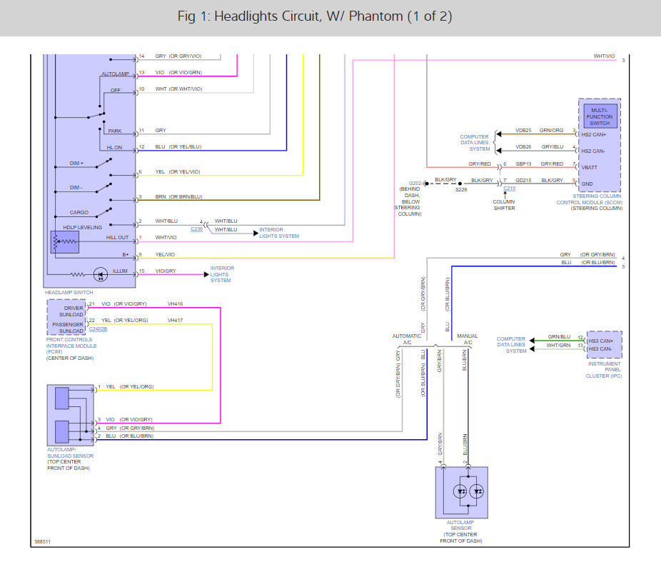

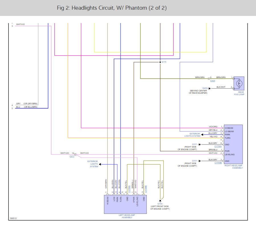

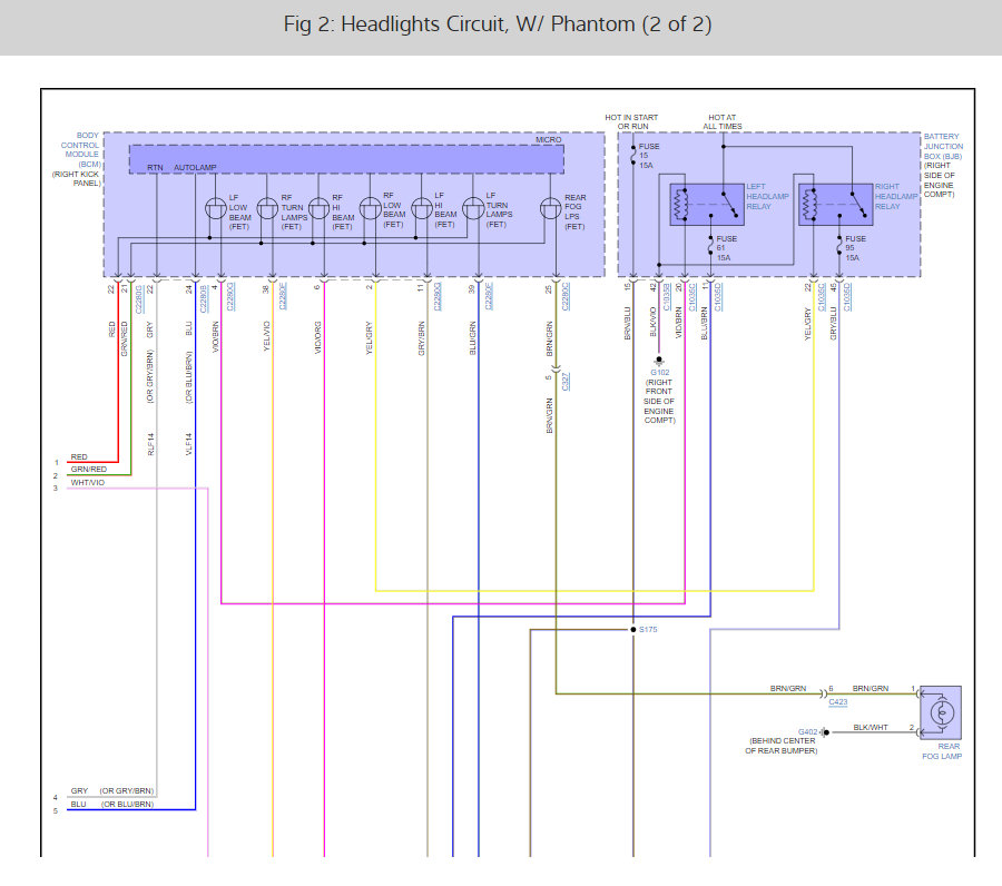

Also, I have included the headlight wiring diagrams so you can see how the system works. If everything is okay, I would say the BCM is out but to be sure we can do a CAN scan, you can get a CAN scanner from Amazon for about $30.00. here is a video to show you how:

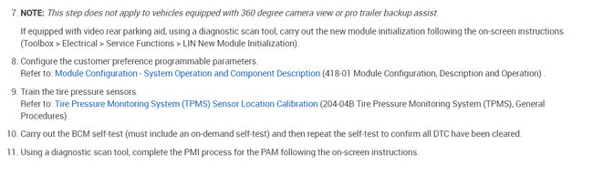

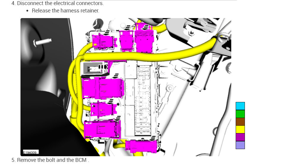

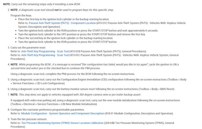

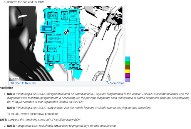

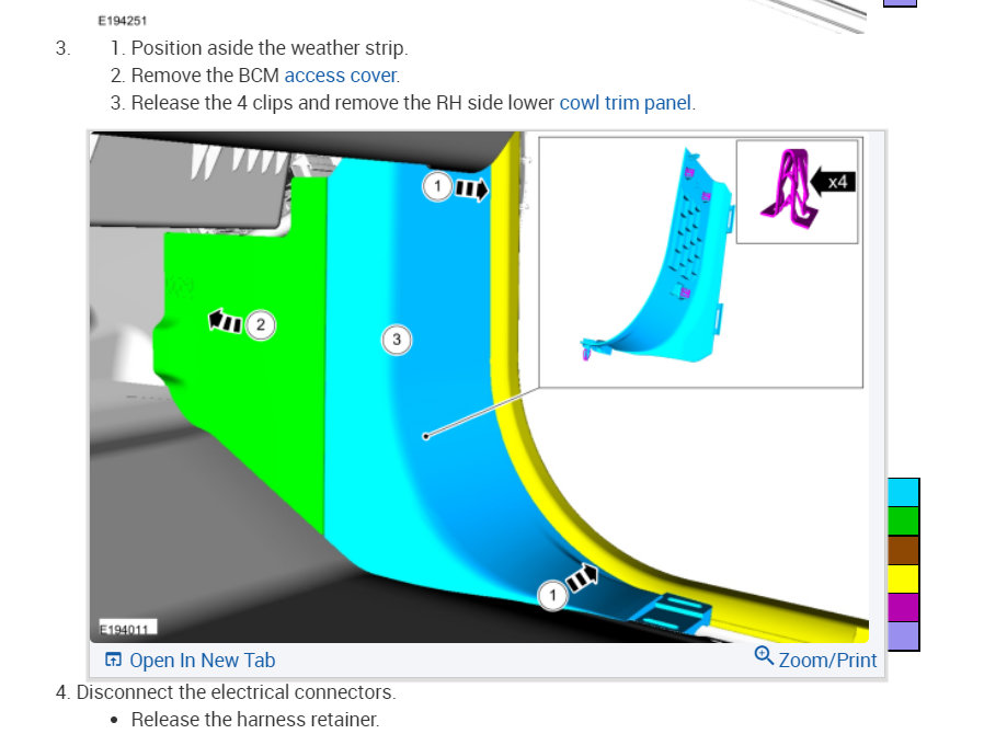

I have included the BCM replacement instructions in case this is the problem. Check out the diagrams (below). Let us know what happens and please upload pictures or videos of the problem.
