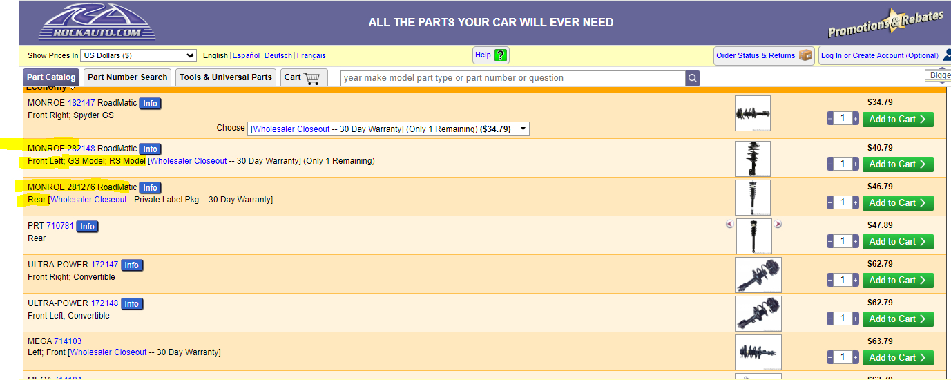

As far as brand, I jumped on Rockauto and found Monroe Quick Struts. They are very fairly priced. If you are looking for the best bang for the buck, that would be my first choice.

See pic below. Note: 2carpros and Rockauto are not affiliated with each other. I only made the suggestion to find a good part at a good price.
