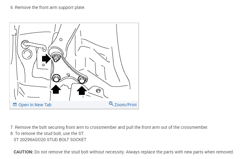

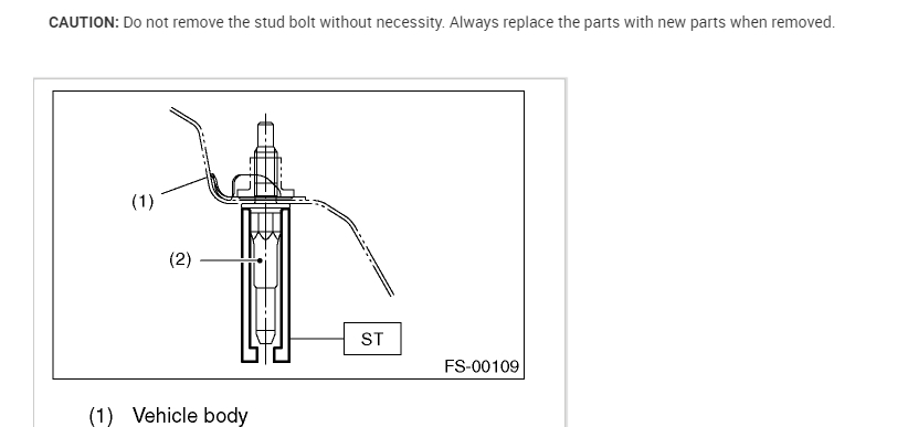

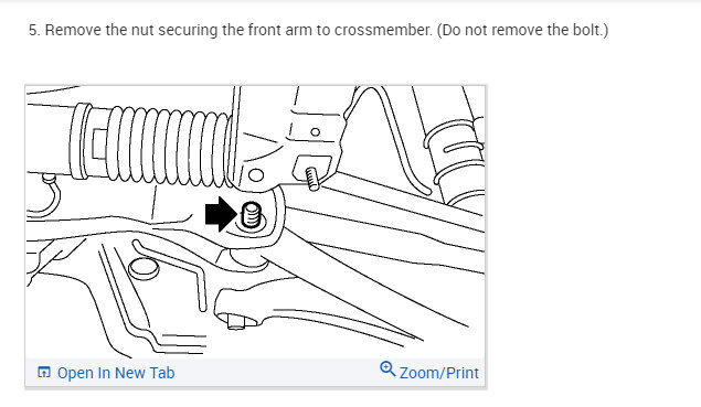

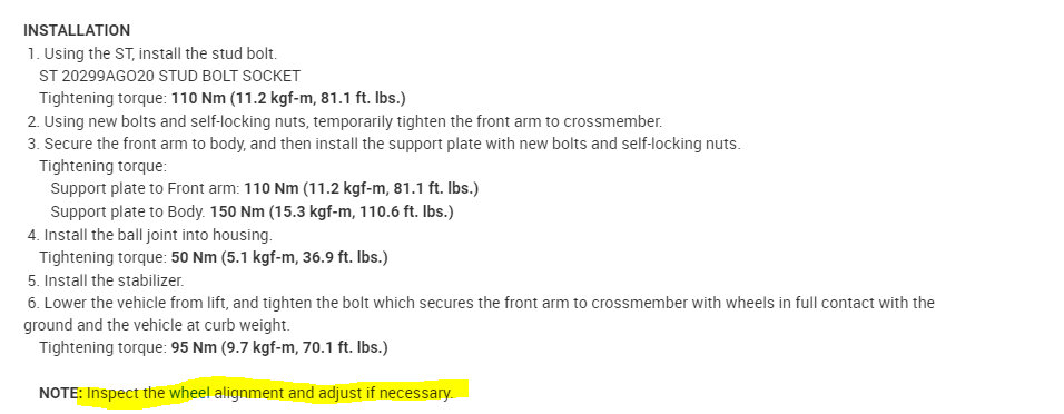

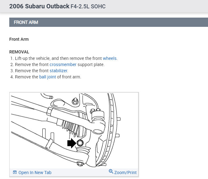

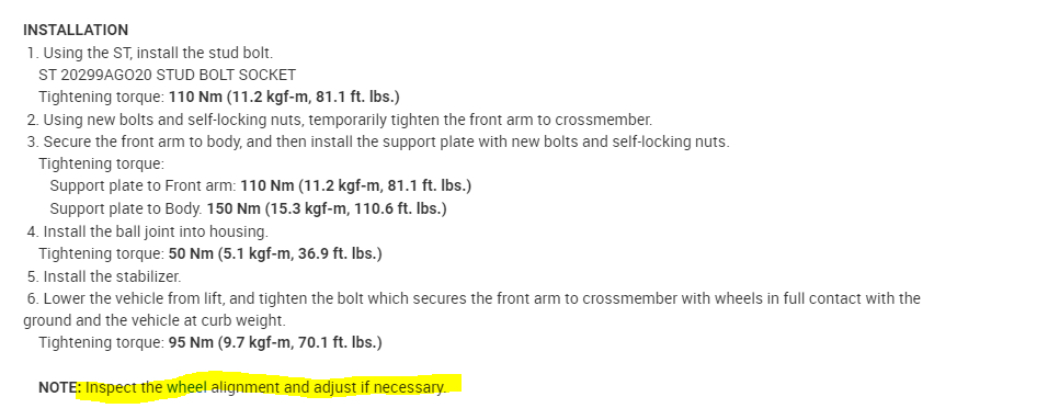

When you did get it back together, did everything appear to be properly aligned? Are you certain that you have the control arm for the needed side?
I attached the direction below that explains how to replace the control arm. Take a look through the directions and see if there is anything you possibly missed.
Also, have you had the alignment checked?
See pics below.
