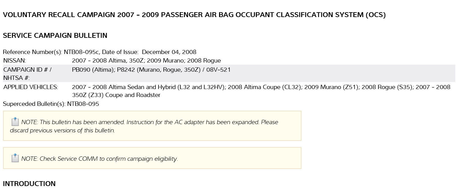

Light does not work, Nissan said it would be around $2,400.00 to fix it. They said the sensor was made in to the seat. any way around this?

there is a campaign on this very thing I have included in picture. have dealer check this . it should be of no cost to you. Your vehicle may not qualify due to VIN number, but I would call Nissan on 800 number before allowing dealer to charge for this.
