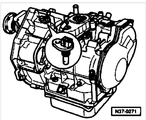

So two of the codes can make the engine stall, but the first code you will notices a jerking like a standard transmission car coming to a stop without putting the clutch in, so to me it sounds like the P0725 code is the issue.
P0740 - Torque Converter Clutch (TCC) Circuit Malfunction
P0725 - Engine Speed Input Circuit
P0441 - EVAP Incorrect Purge Flow
I would replace the engine speed sensor (crankshaft position sensor). Here is the location, the P0441 code could have been because the gas cap was off. I would clear the codes once the repairs have been made. Check out the images (below). Let us know how it goes.

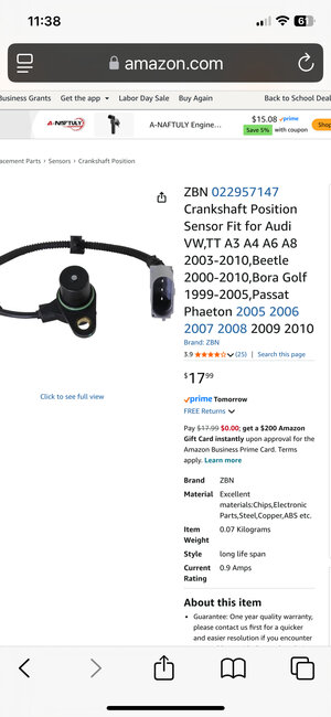

Thanks for that info! When checking online the OEM part is extremely expensive.
I did a search on Amazon and came up with this. It seems to be the right part number, but it doesn’t mention my euro van in the description.
Is this still the correct part?
Aug 20, 2025 at 8:38 AM
It looks correct, I would get it and give it a try to see if it works, 17 bucks cant go wrong.

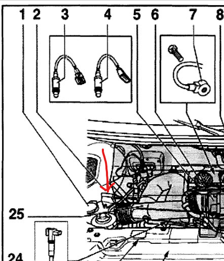

Did you replace the crankshaft sensor? Also, when it wont start I would unplug the MAF sensor, when these short out it will shut the engine off, so just unplug it and see if anything changes.

Yes, unplug the MAF sensor when the engine stalls to see if it wills tart back up again, if so replace the sensor. I marked where the sensor is, check out the images (below). Let us know how it goes
