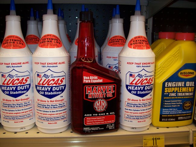

FOR WHAT IT'S WORTH (SOME PEOPLE DON'T SUGGEST ADDITIVES- I'M DIFFERENT!)
NEXT OIL CHANGE SUBSTITUTE 1 QT OF MARVEL MYSTERY OIL, FOR A NORMAL QT OF OIL YOU WOULD NORMALLY PUT IN (NOT ADD A QT, AND BE OVERFILLED BY A QT!). WHILE YOU ARE DRIVING, "MMO", MAY CLEAN IT UP, "MMO" CAN BE LEFT IN, UNTIL NEXT CHANGE...OR YOU CAN RUN A NEW BATCH....READ THE BOTTLE!
IF YOU GET IT TO QUIET DOWN, YOU MIGHT DO WHAT I DO, I USE OIL STABILIZER EVERY OIL CHANGE IN MY 1977 JEEP CJ 5. I DRIVE IT ALMOST EVERY DAY, AND I REBUILT THE ENGINE IN '96, IT IS STILL GOING STRONG. (I DID NOT USE THE STABILIZER UNTIL MY 4TH OIL CHANGE, I WANTED TO INSURE MY CYLINDERS WERE BROKE IN WELL AT ABOUT 12,000 MILES).....I HAVE NOT HAD ANY TAPPET ISSUES WITH THIS ENGINE, BUT I HAVE USED THE "MMO" ON PREVIOUS CJs I HAD
I HAVEN'T HAD TO USE MARVEL MYSTERY OIL IN MY PRESENT CJ 5....I HAVE HAD 5 OTHER CJ 5s PRIOR TO THIS ONE, THE MMO, HELPED WITH SEVERAL OF THEM. I HAD ONE THAT WOULD NOT STOP, I USED A LITTLE MORE DRASTIC MEASURE WITH IT, BY INSTALLING A PUSH ROD A FEW THOUSANDTHS LONGER THAN THE ONE THAT WAS PUSHING ON THE ONE THAT WAS DOING THE "TAPPING". THAT SORTA JUST RE-POSITIONED THE PLUNGER INSIDE THE TAPPET AND IT BEGAN "SEALING" AS IT SHOULD, AND THE TAPPING CEASED.
IT ONLY TAKES A LITTLE STUCK ON BURNT LOOKING OIL ON THE THIN STEEL DISCS INSIDE A TAPPET TO KEEP A TAPPET FROM SEALING.....I'D TRY THE MARVEL MYSTERY OIL 1ST, BEFORE GOING ANY DEEPER. DO OT OVERFILL YOUR OIL, DRAIN OUT A QUART, THEN INSTALL A QUART OF MARVEL MYSTERY OIL
THIS STUFF HAS BEEN AROUND SINCE WWII, YOU CAN FIND ENDORSEMENTS ON YOU TUBE, BEATS TEARING INTO ONE!
THE MEDIC
