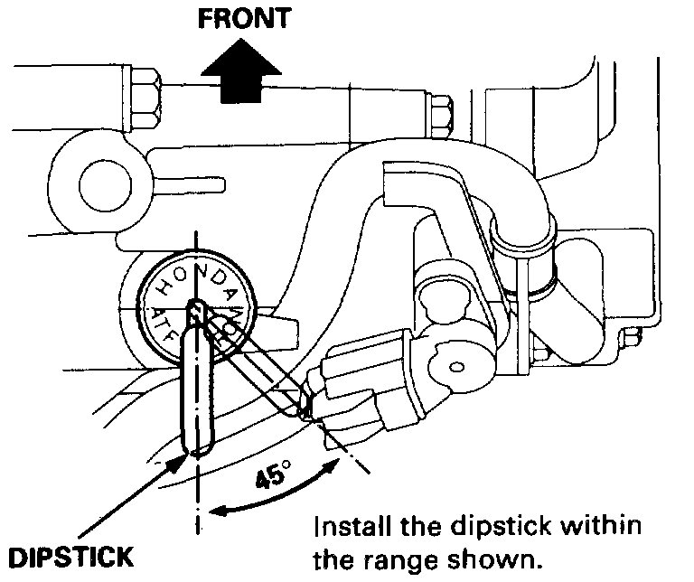

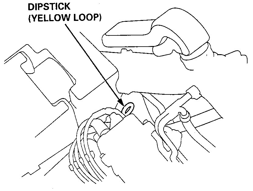

3. Remove the dipstick (yellow loop) from the transmission, and wipe it with a clean cloth.
pic 1

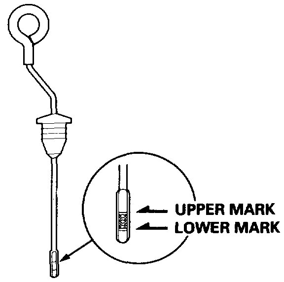

4. Insert the dipstick into the transmission.
pic 2
5. Remove the dipstick and check the fluid level. It should be between the upper and lower marks.
6. If the level is below the lower mark, pour the recommended fluid into the filler hole to bring it to the upper mark. Always use Genuine Honda Premium Formula Automatic Transmission Fluid ATF). Using a non-Honda ATF can affect shift quality.
pic 3
7. Insert the dipstick back into the transmission in the direction shown.
