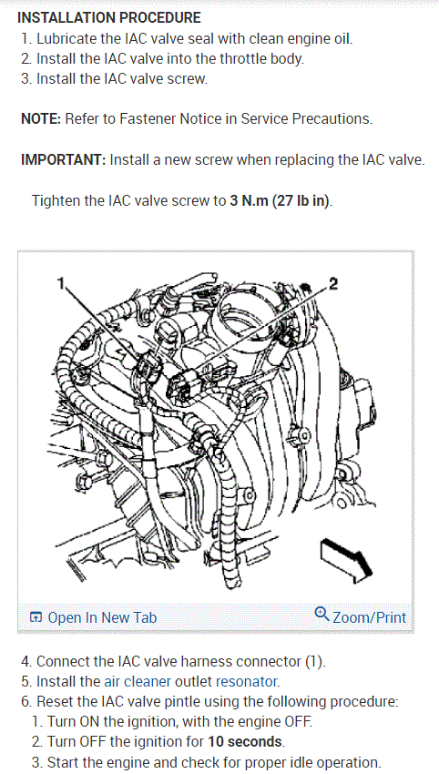

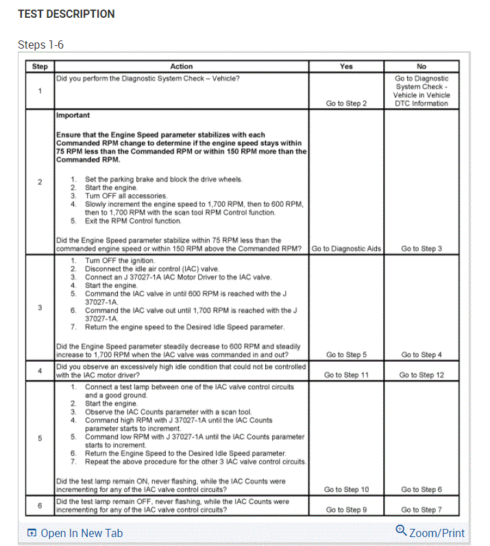

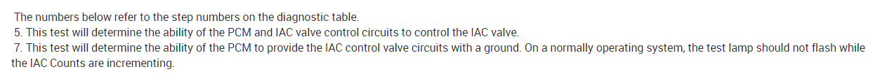

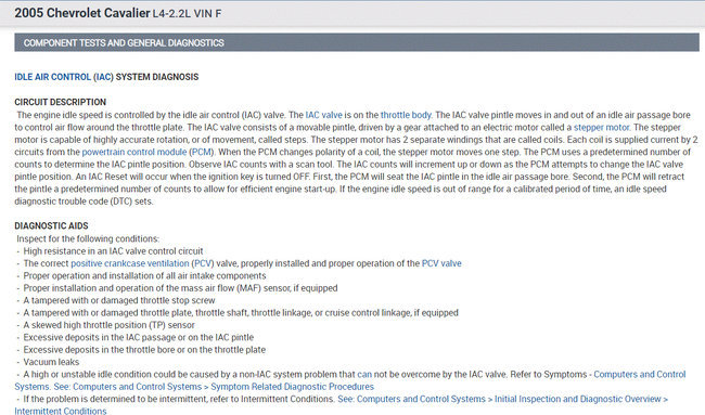

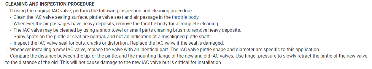

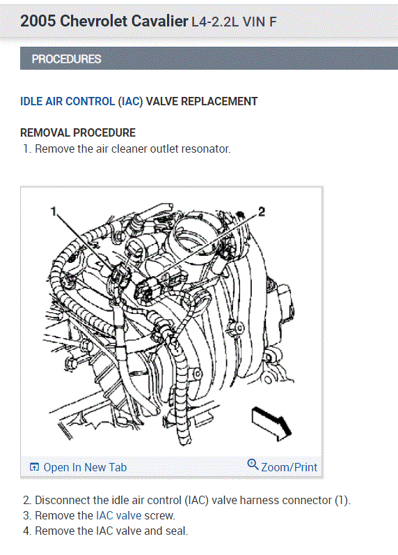

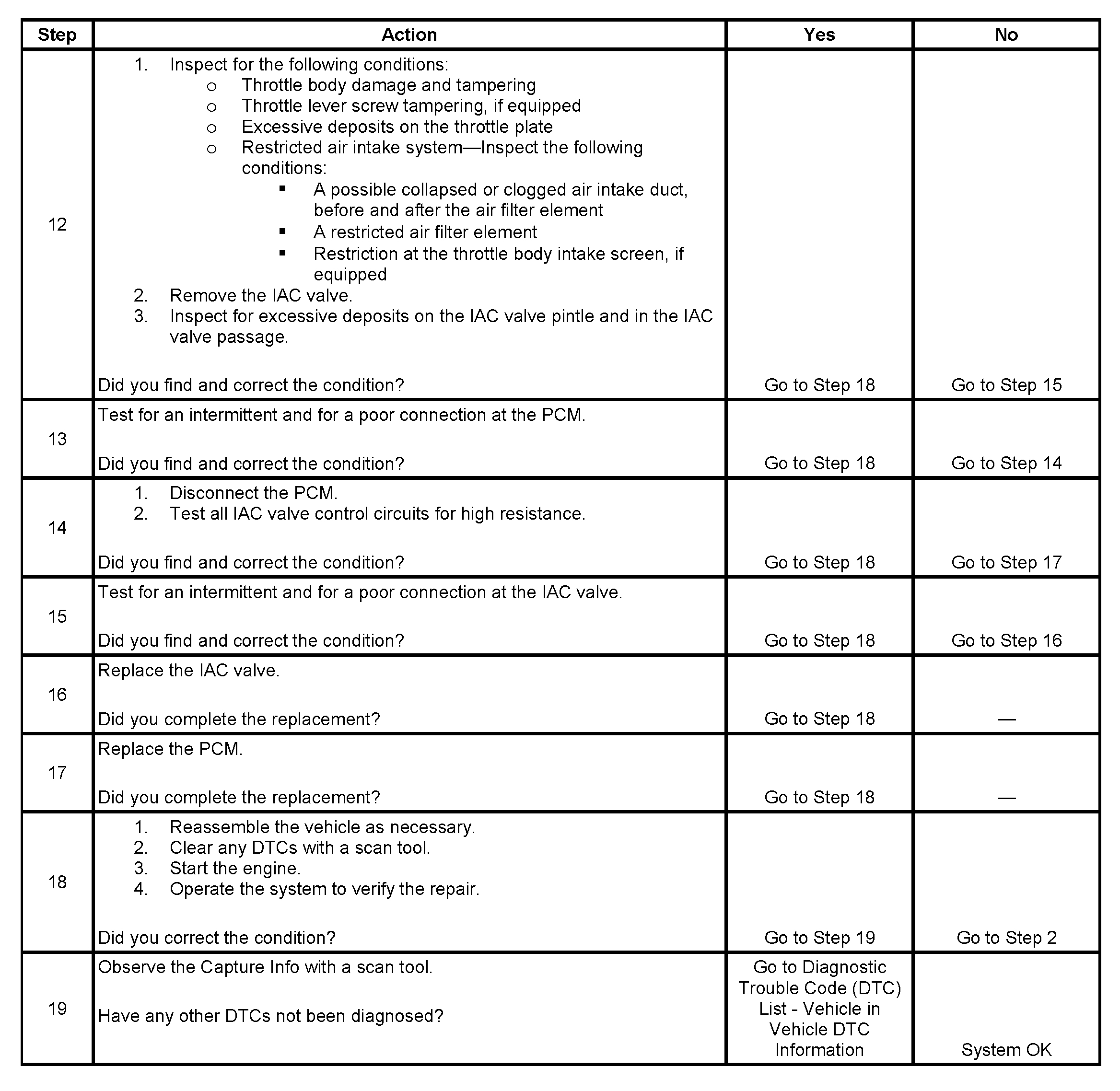

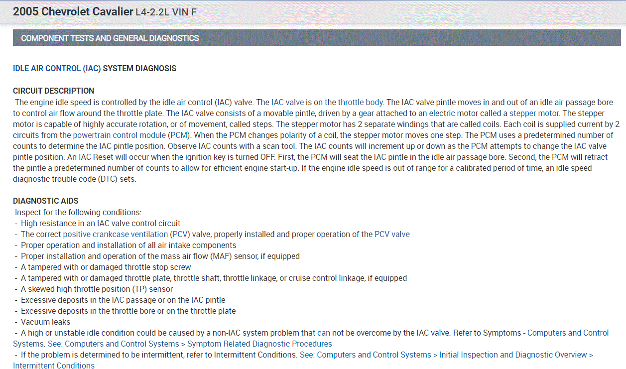

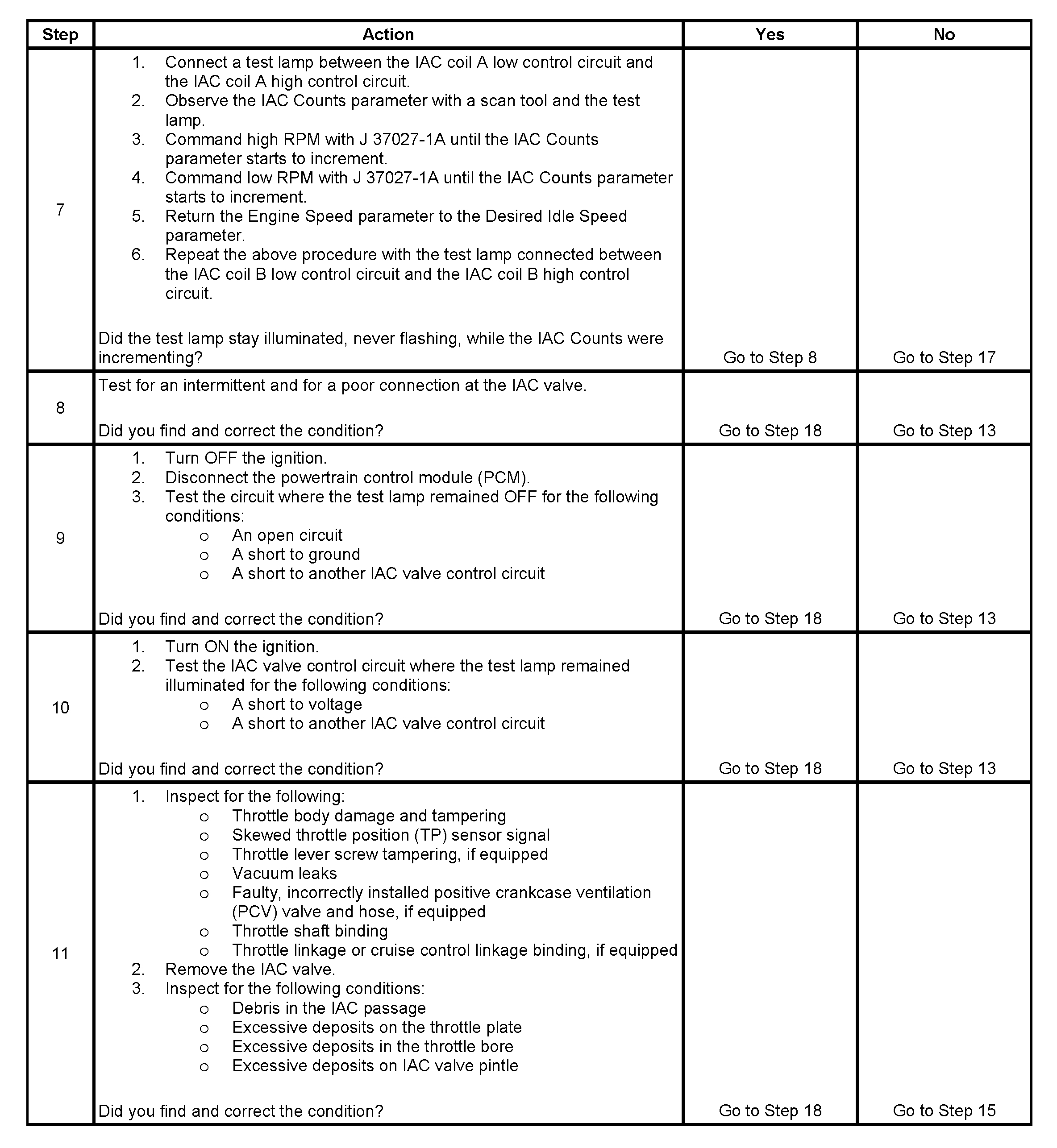

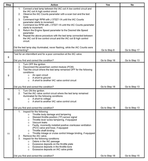

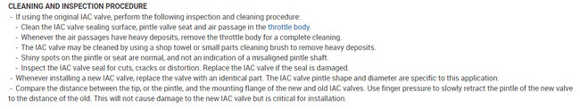

Before you simply replace it, you may want to test it. The first five pics below are the testing procedures. They are specific to your vehicle.

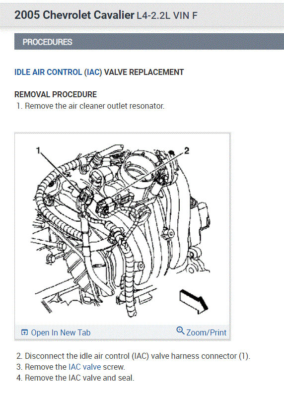

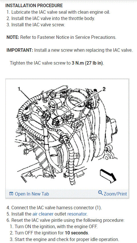

If needed, the remaining pics are the directions/pics specific to your vehicle for replacement.
I hope this helps. Let me know if you have other questions.
See pics below.
