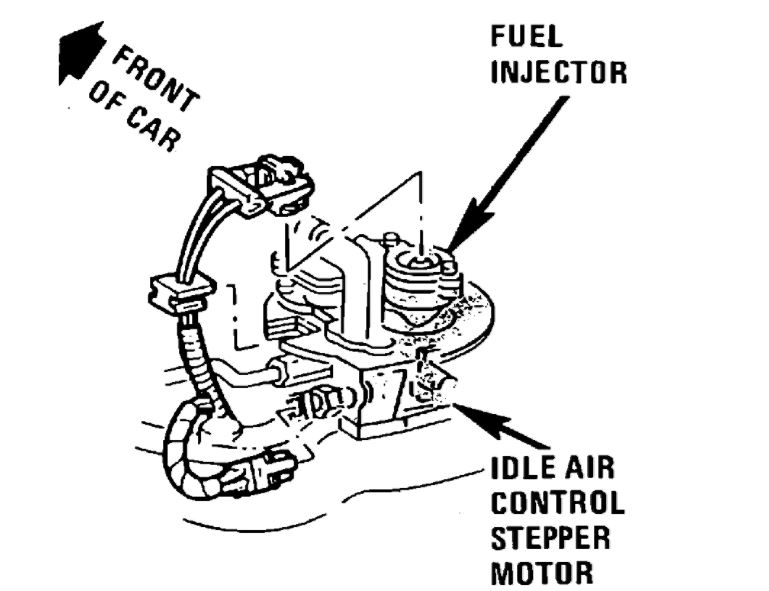

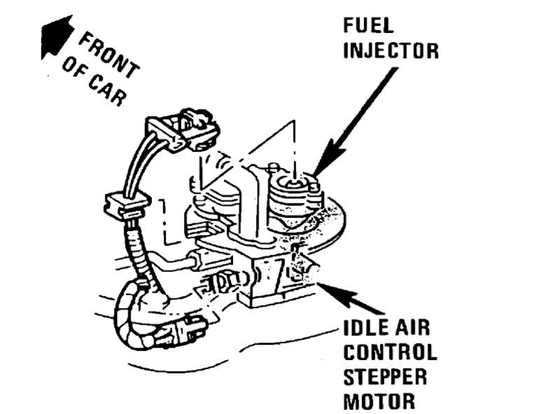

The most common issue for this is the idle air control on the throttle body. remove it and clean the passage of all carbon. usually carbons up and the valve sticks.
I attached a picture below to show you the location of the idle air control.

Roy, thanks for the response. I just have one quick question. What should I use to clean out the IAC valve passage? I have some throttle body cleaner, but am concerned it might harm the IAC valve itself after reinstallation.
Apr 23, 2018 at 3:36 PM
I use 2+2 carburetor cleaner and a small wire brush that can get into the small areas.
Apr 23, 2018 at 4:23 PM
JOECOOLAMI
Roy, I, and on behalf of my beloved Fiero, would like to extend our gratitude to you for you assistance. Even though the IAC valve was new, there was carbon buildup in the passage that was causing it to get stuck. I was not able to get in there with a wire brush like you said, as I purchased brushes too big, bit I did manage to scrape off a lot of residue with the help of some cleaner and a paper towel wrapped around my pinkie. Should issue arise, I will get the proper brush to give it a thorough cleaning. Took my car out for its first real drive and it drove magnificently! Thanks again!
