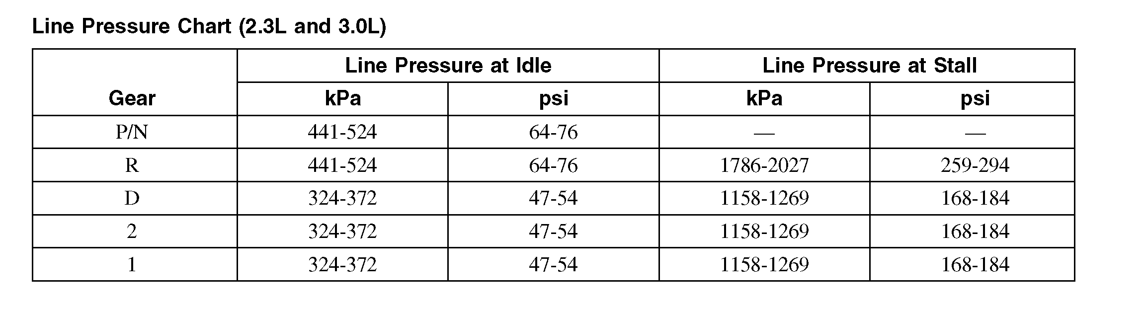

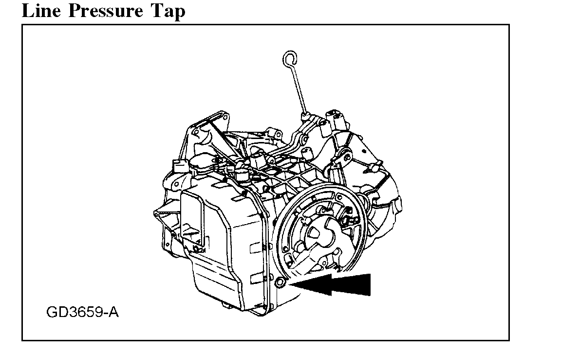

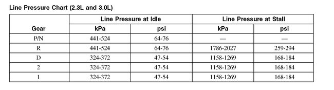

The last thing I would check is line pressure. If line pressure is low, it will struggle to shift into gear. Here are directions for testing line pressure. The attached 2 pics correlate with the directions.

1. Remove the line pressure port plug.
2. Connect pressure gauge to line pressure tap.
Line Pressure Tap
pic 1
3. Start engine and check line pressures. Refer to following the Line Pressure Chart to determine if line pressure is within specifications.
4. If line pressure is not within specifications, carry out on-board diagnostics and pinpoint test, air pressure check and repair main control system or pump as required.
5. After completing the line pressure test install the line pressure port plug.
^ Tighten to 14 Nm (10 lb-ft).
Line Pressure Chart (2.3L and 3.0L)
pic 2
