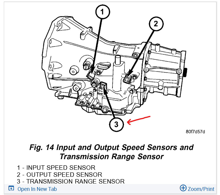

Nice work, that would be the problem then, if the gear range sensor does not detect the transmission is in reverse the PCM will not command the transmission to be in that gear. Here is how to change the gear range sensor (neutral safety switch out, then clear the codes after the repair which should fix the problem.
A P0700 code indicates a general transmission control system malfunction

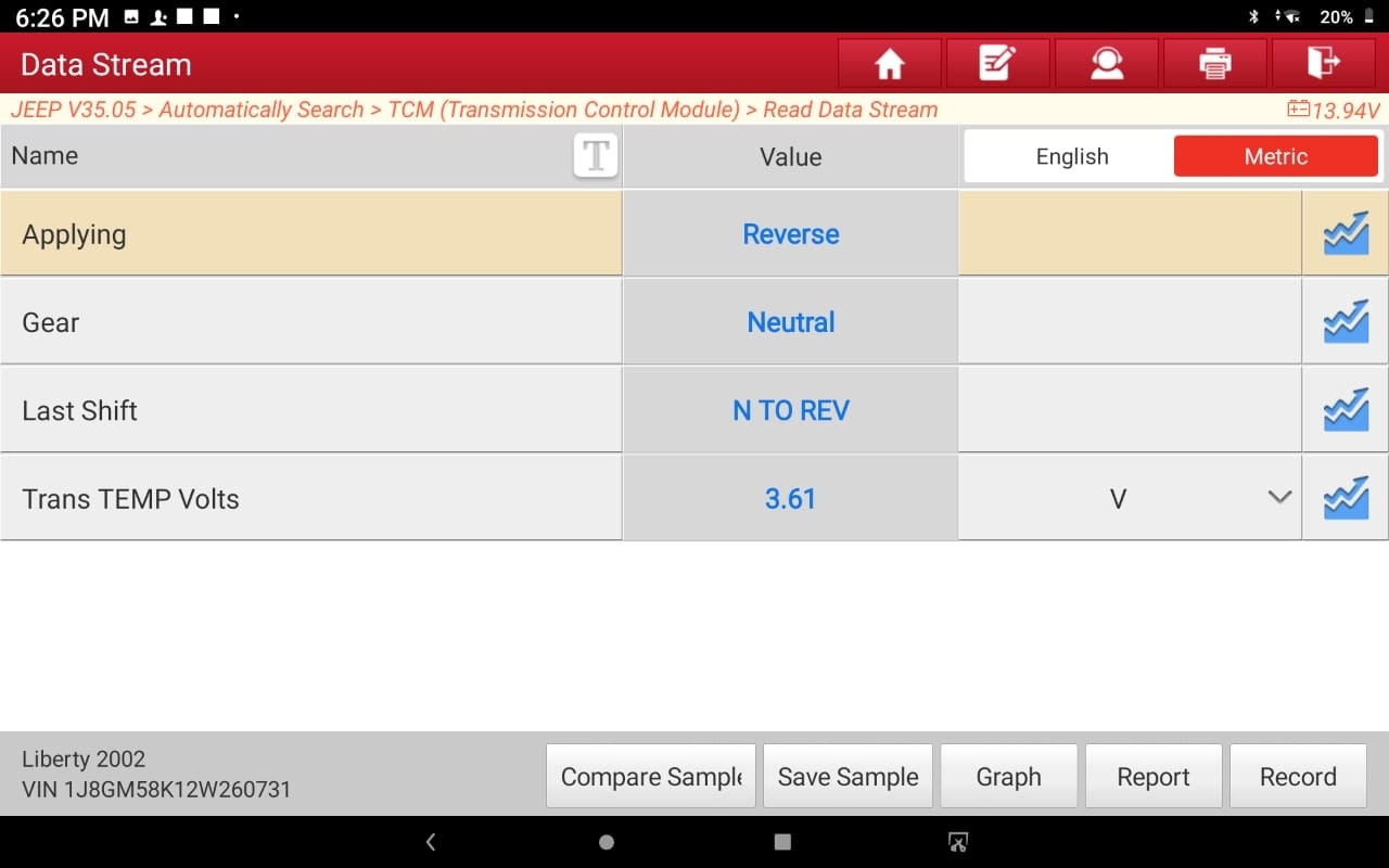

I will ask the mechanic to do that, he also sent the following picture.
Mar 3, 2025 at 12:17 PM
Yep, you can see the PCM is in the neutral state and not commanding the transmission to go into neutral. Please let me know what happens after the repairs.
