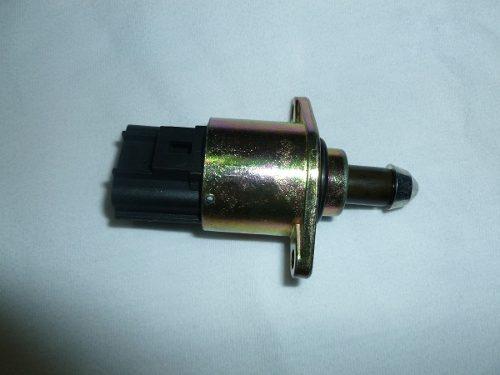

I have been googling the "valvula de Pare" and it comes up as IAC (Idle air control) valve.
I will look at the neutral safety switch - is this the same part as the IAC sensor valve/solenoid? I attached a picture.

no they aren't the same iac controls idle of engine and neutral switch lets you start car in park/neutral and controls back up lights
