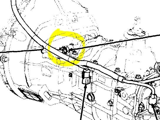

There are two things to check. Considering the mileage, my guess is the linkage to the transmission range sensor is loose. So, I attached two pictures. One is the range sensor and the other a switch for the reverse lights. Based on which system you have, one or the other will be there. I circled both in the pictures.
Check for play in the linkage that doesn't full return the switch to reverse when it moves from drive.
Let me know what you find.
