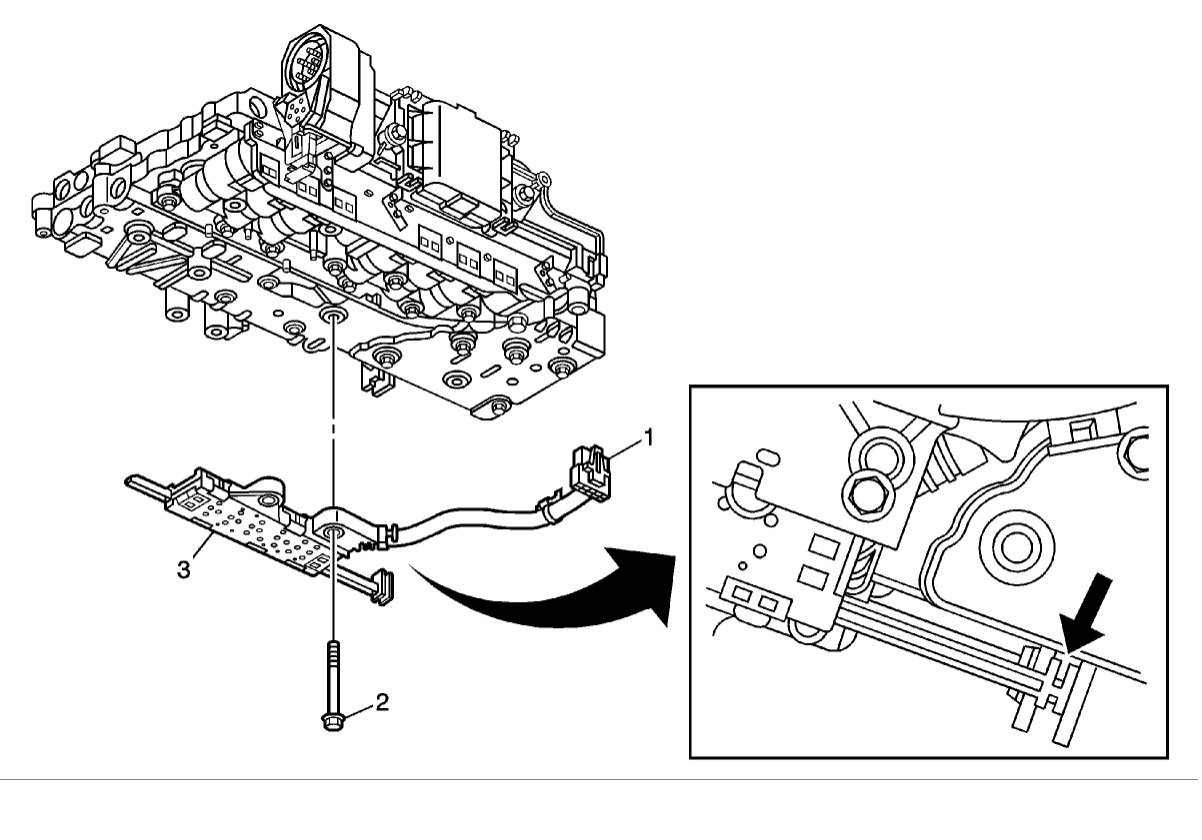

It sounds like you have a problem with the transmission selector switch which would affect the rear camera as well.
Here is a diagram for the location of the switch which is inside the pan near the valve body.
Best, Ken
