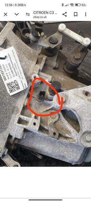

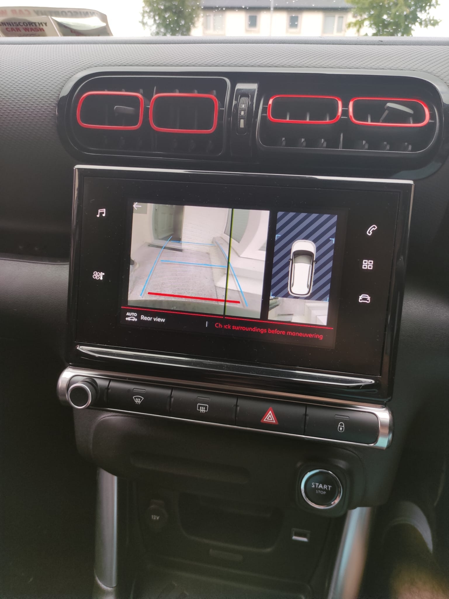

The reverse light, camera and parking sensors don't work, my guess is the reverse light switch on the gearbox is faulty. The engine seems a bit tucked back in the engine bay, I'm wondering how can I get at the reverse light switch to replace it.
