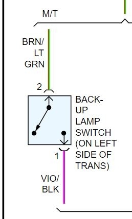

If you connected the brown/light green wire to the violet/black wire and the lights turned on when the key was on, replace the switch. I attached a portion of a wiring schematic to confirm.

Good it's working. thanks for the information.
