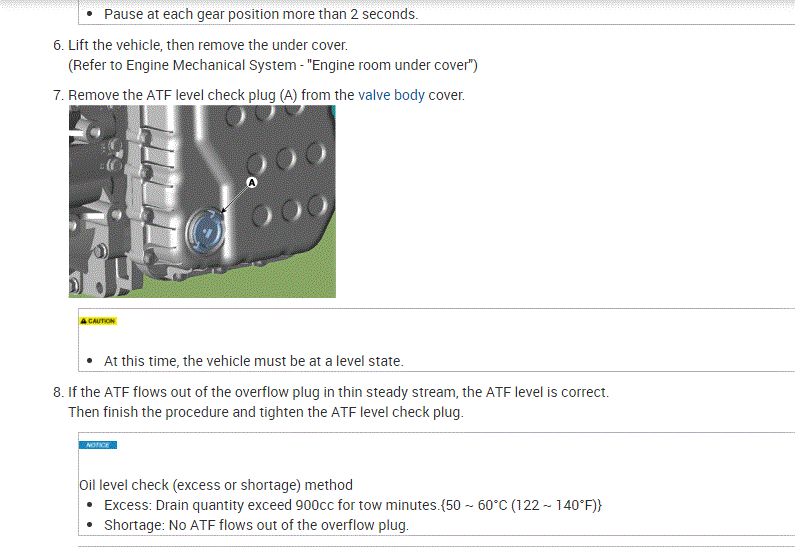

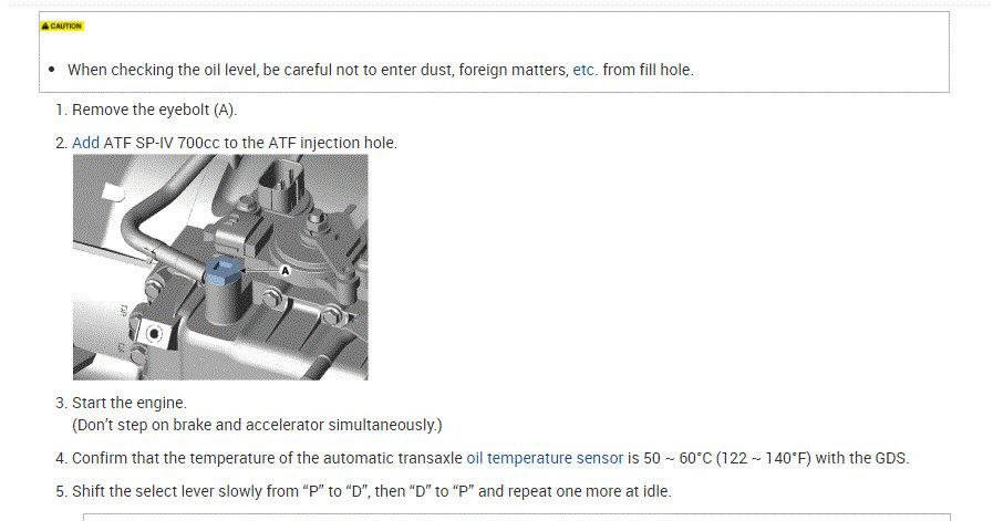

Did you check the fluid level? I would start there.
https://www.2carpros.com/articles/automatic-transmission-problems

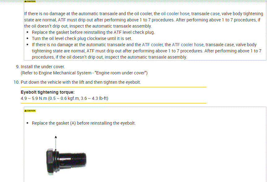

Beyond that, when was the last time you change the fluid? It is a once a year service.
I attached the procedure for checking the fluid and changing the fluid for you.
