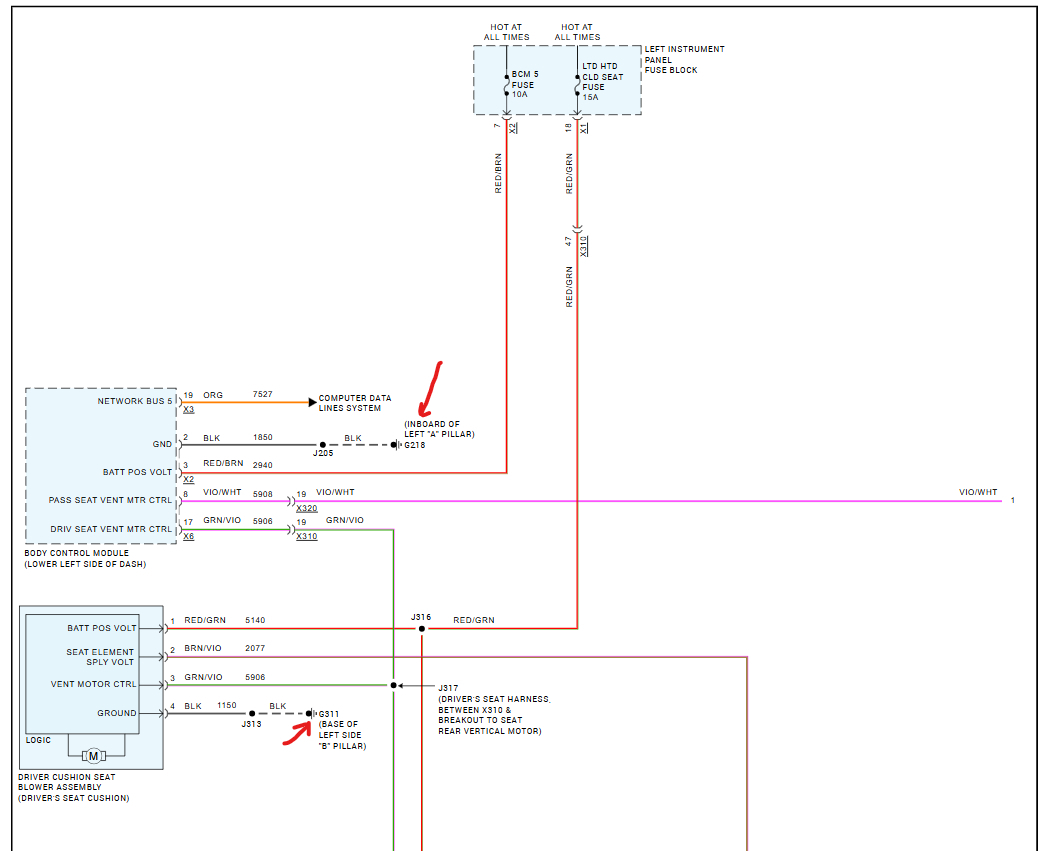

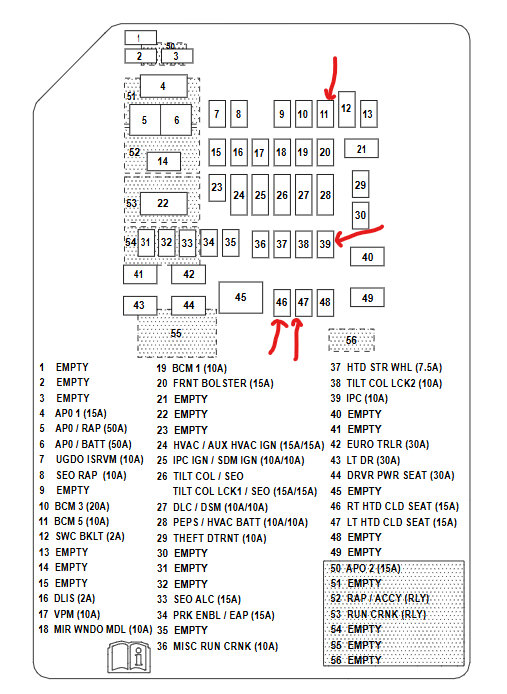

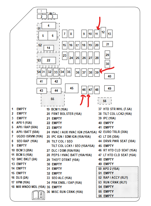

We can help be we only handle one problem at a time, please start new threads for the problems except for the heated seat which we will handle on this thread. Let's start by checking the fuses for the heated seats, can I ask if any lights work for the seat heaters? We need to check the fuses that run the system (4) BCM5, LTD HTD CLD SEAT, RT LTD CLD and the IPC fuses. Here is a guide to help and the fuse locations in the images below:
The fuse panel is at the left side of the dash. Check out the images (below). Let us know how it goes.
Mar 11, 2025 at 1:49 PM
VIKOZ6712
No lights on at all. All fuses look good. Checked again, still no power.
Mar 11, 2025 at 3:40 PM

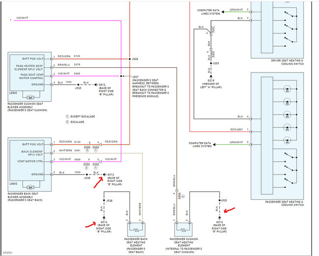

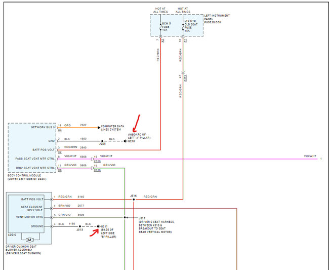

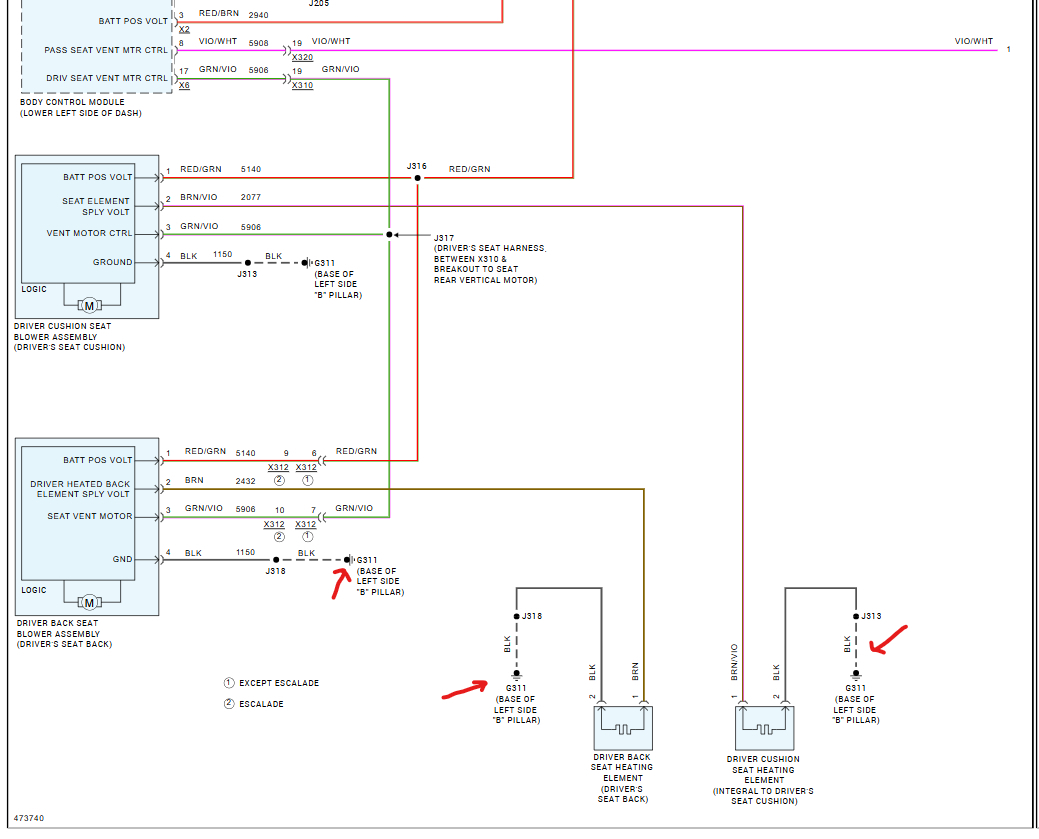

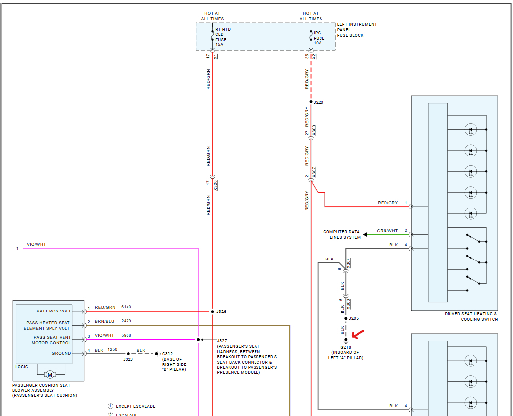

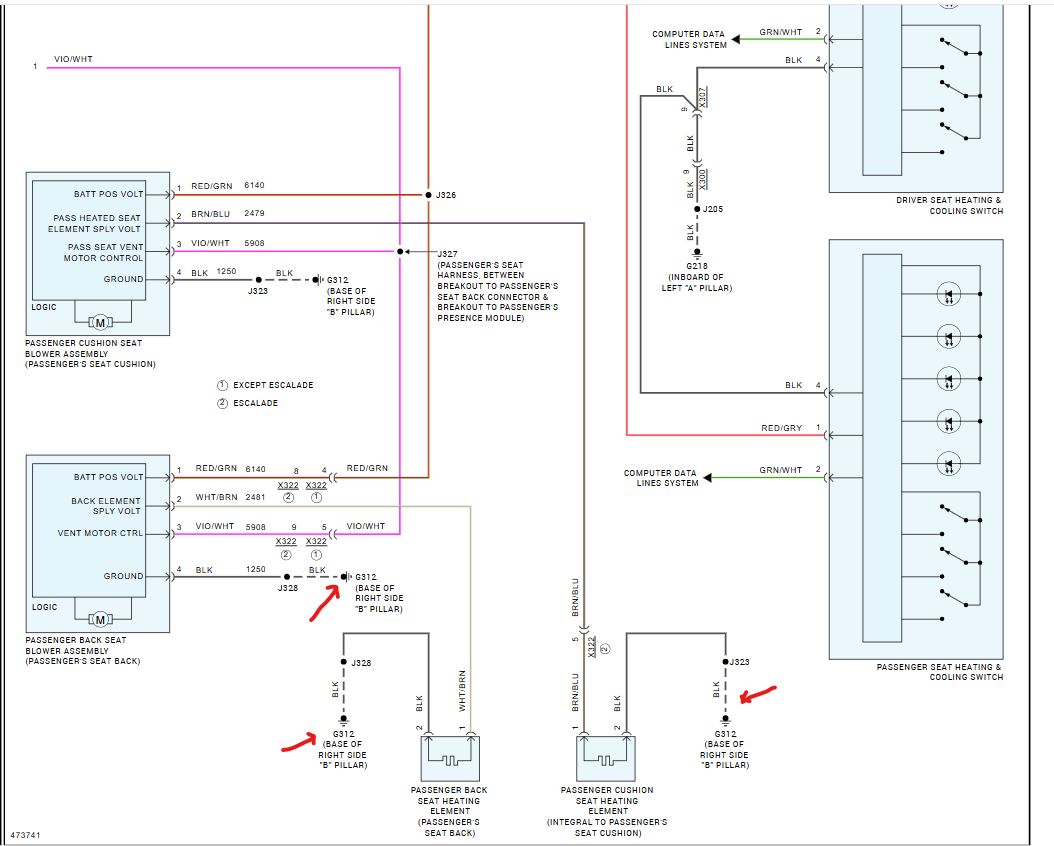

Okay, there are 2 main grounds to the system which can be cut or undone. Here is the clement controlled seat wiring diagrams which show the grounds, G133 and G218. Here are the locations of the grounds which must be checked. Check out the images (below).
