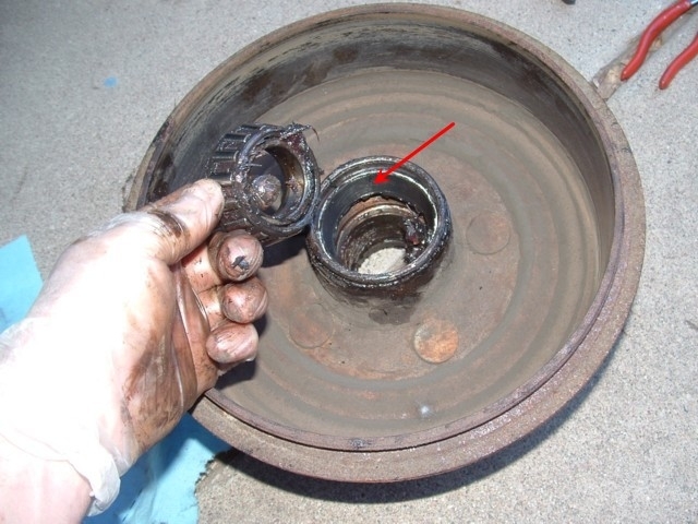

I dismantle the drum and i removed the two tapered bearing (the small and and bigger one). I would like to send it to resurfacing, so i would like to know if i can sent it without remove the inner race (attached photo)? Will it disturb to lock the drum into the axis of the resurfacing machine and the machine may damage the race?or i can leave it as it is?

Here is the attached photo.My drum more or less looks like that.

Most places will turn the drum using a tapered arbor on either side of the hole. The will center up in the cast iron, not the races.

Leave the races in the drum. If for some reason they are in the way, the shop will probably remove them.
