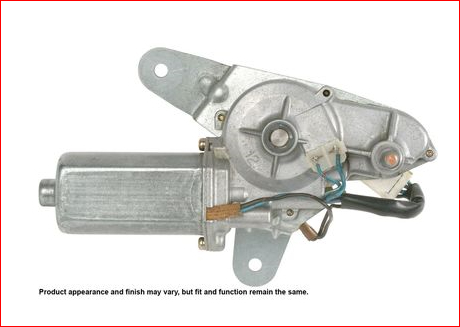

The resistor inside the front wiper motor seems to be burned open. This looks like a current limiting resistor. It is mounted internal to the motor. What part number is it so that I can replace it? I cannot find any information on it.

It is going to be hard to find a part number for just that Resistor. All auto part stores and auto dealerships are just going to sell you the complete Wiper Motor as an assembly (picture attached). Maybe you can try an electronics store as an alternative and try to repair yourself if you do not want to replace entire unit. Hope this helps and feel free to ask any questions.Thanks for using 2CarPros.
