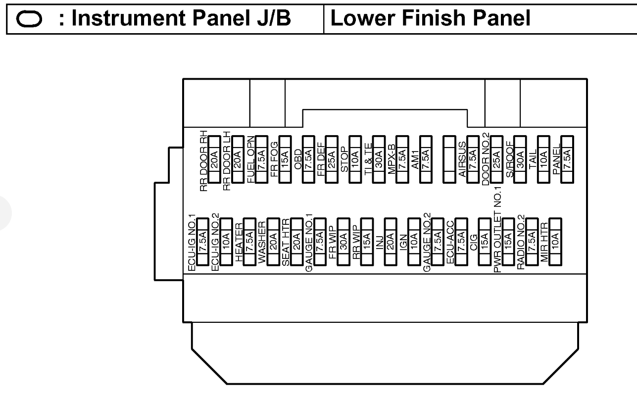

There is an OBD fuse in the fuse panel inside the car. here is a guide so you an check it for power:
