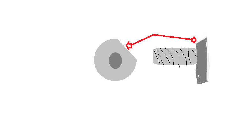

The proper way to replace it is to remove the hub assembly, which is a big job. What I have done (not telling you to do it) is grind a small portion of the base off so that you can get the angle needed to install it.
Take a look at the pic I tried to draw. See if you grind it like that if you will be able to get it installed.
See pic below. Sorry, it looks like a 3-year-old did it.
