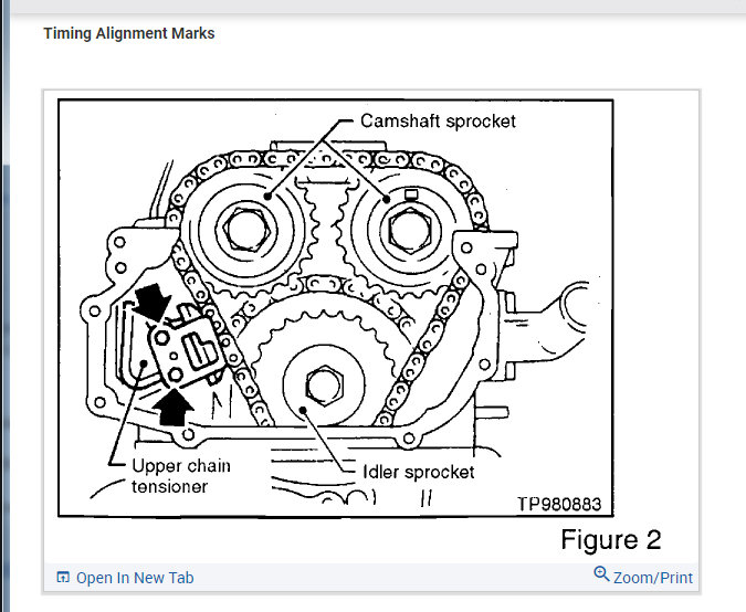

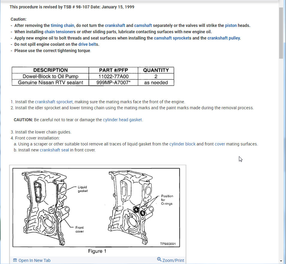

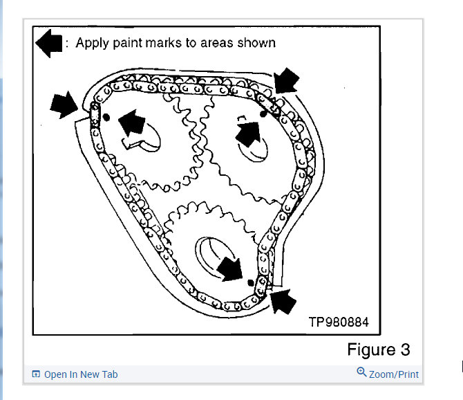

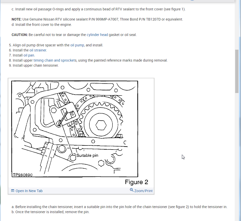

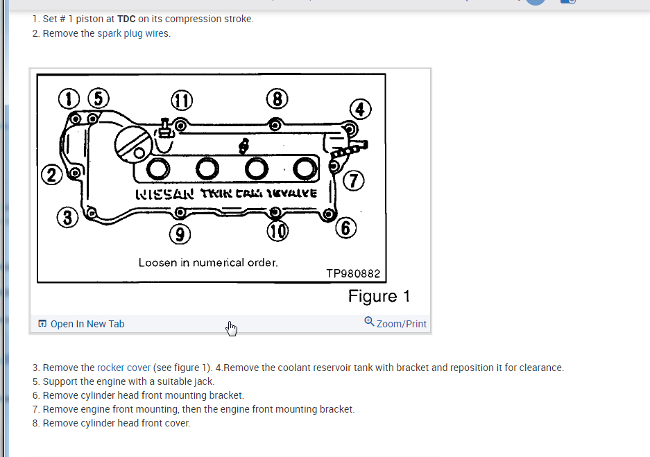

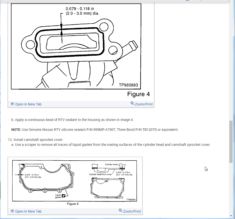

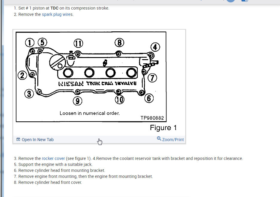

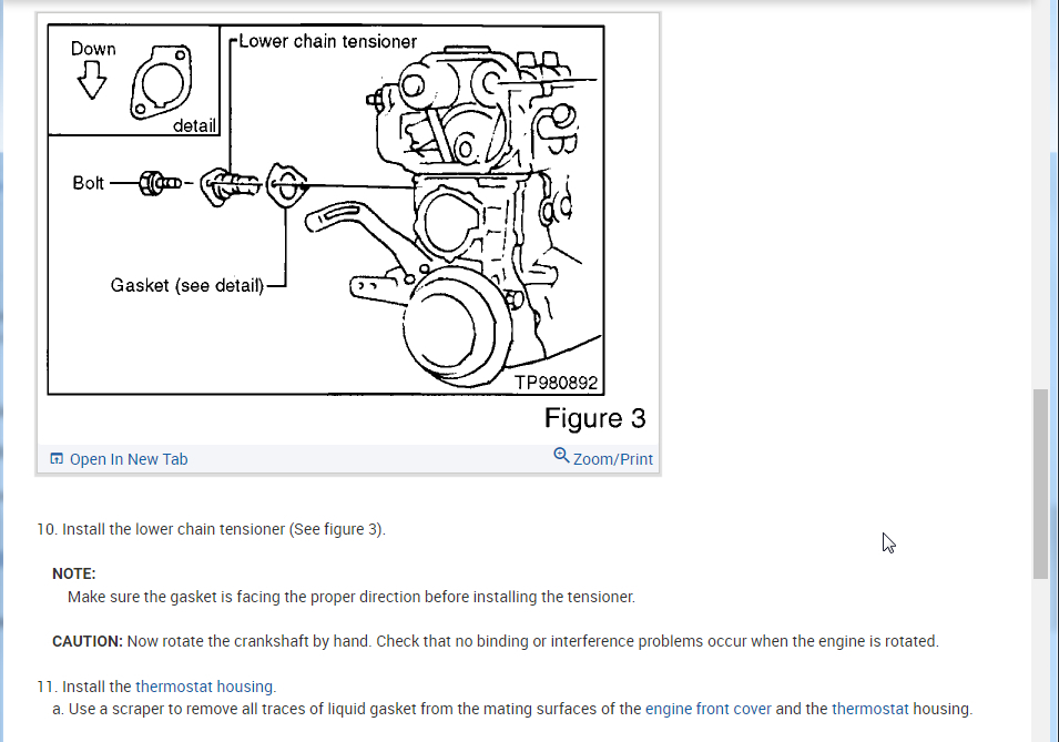

Just wanted to get everything since I will be replacing the gasket on timing cover and the valve cover. Replacing upper/lower tensioner also dampers if needed. Wanted also to know to set the timing. GA16DE GXE
Nov 20, 2020 at 8:49 AM

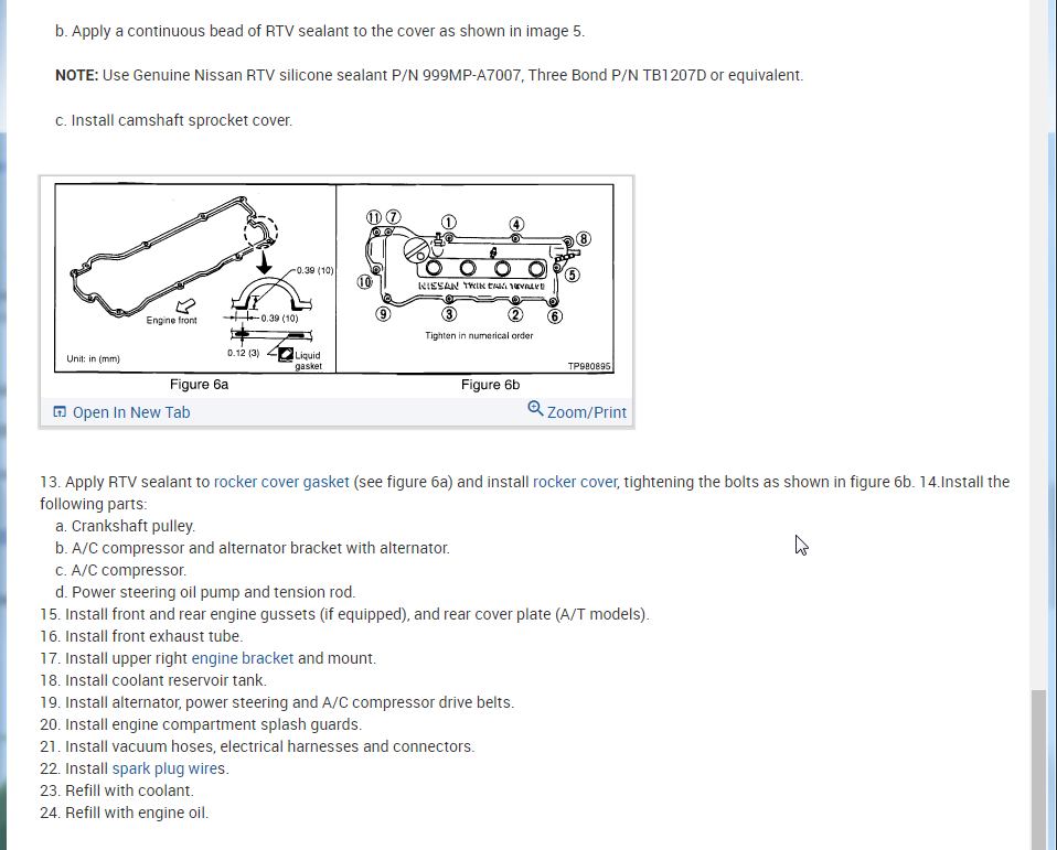

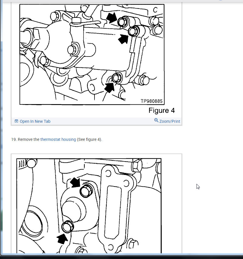

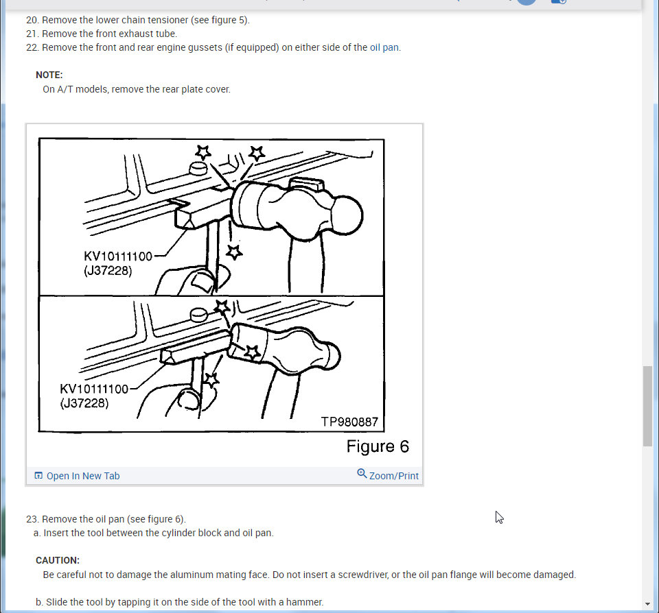

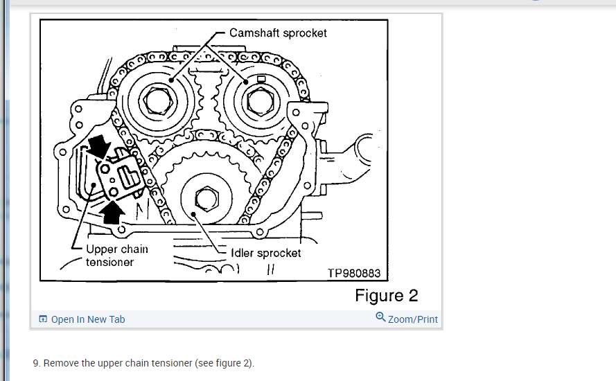

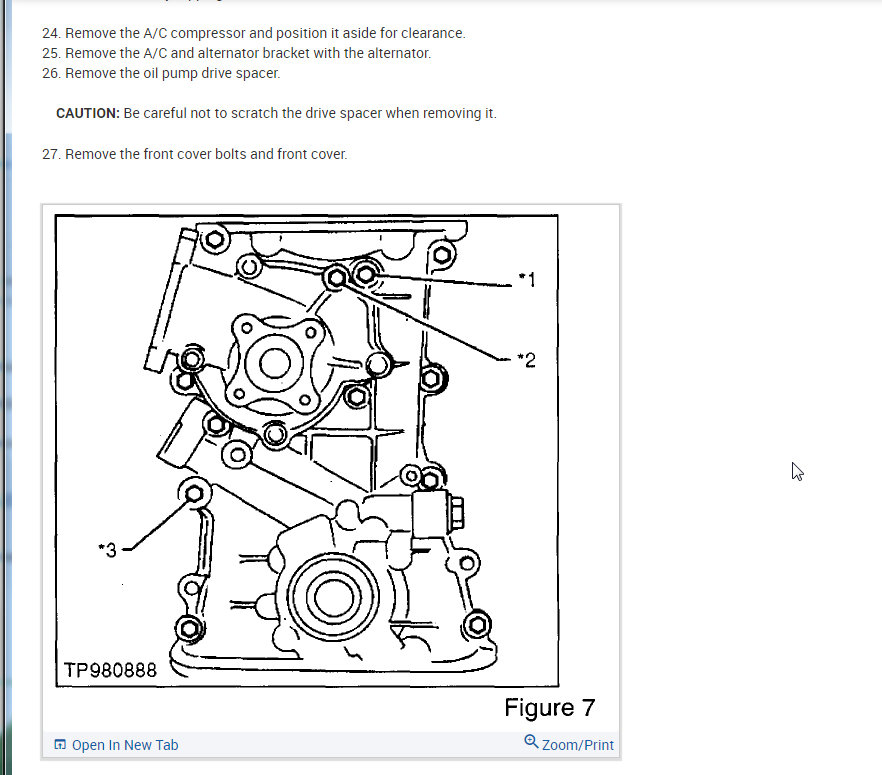

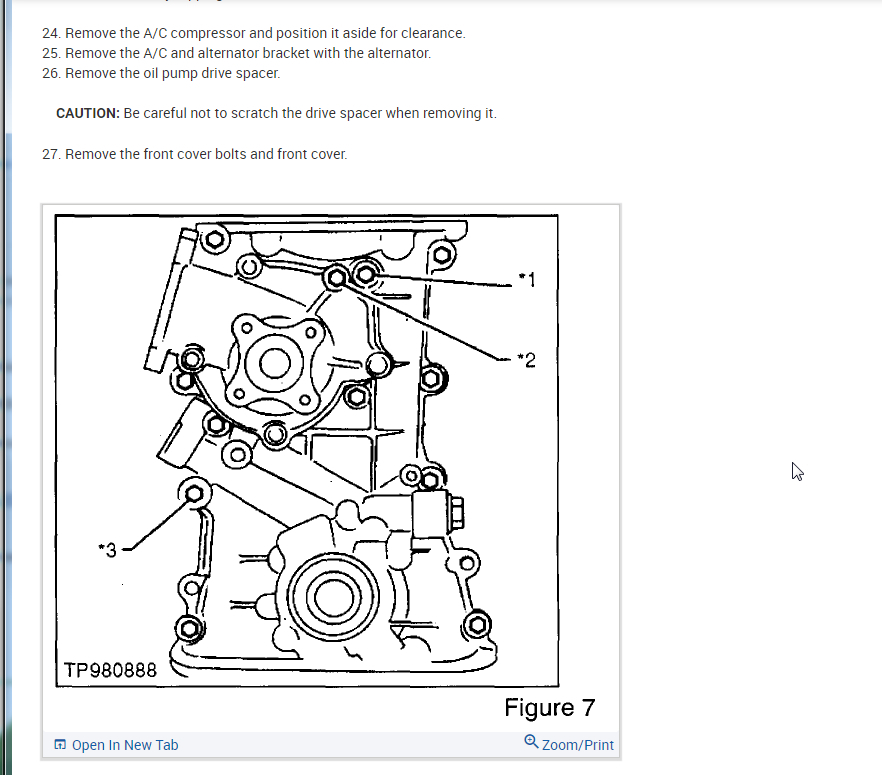

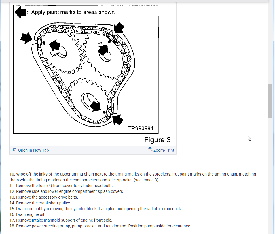

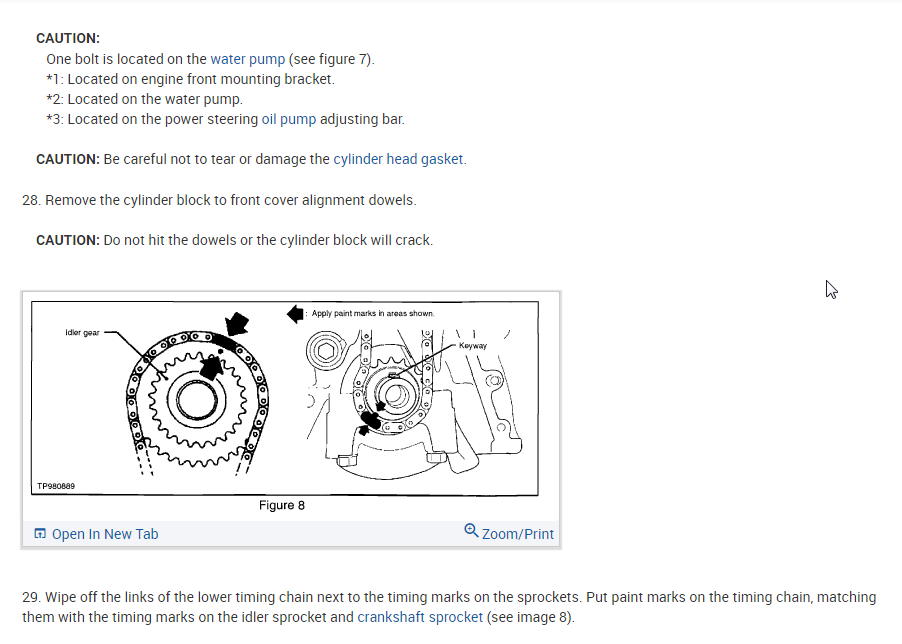

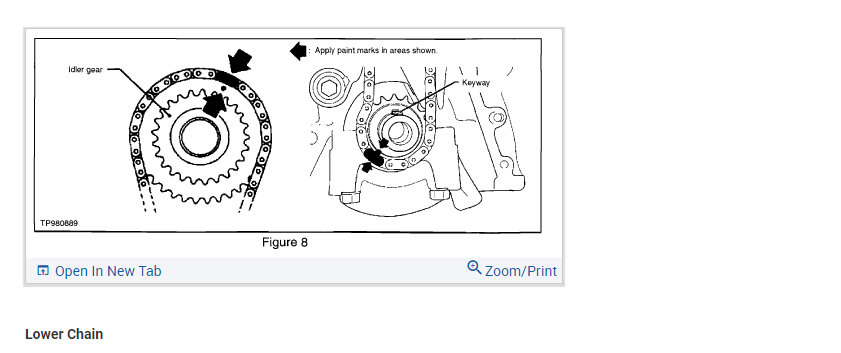

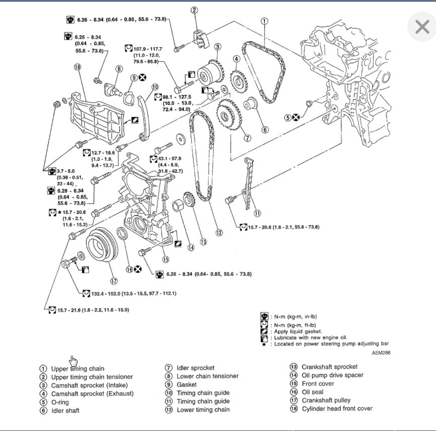

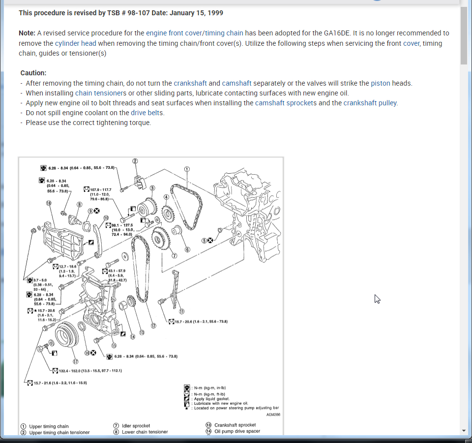

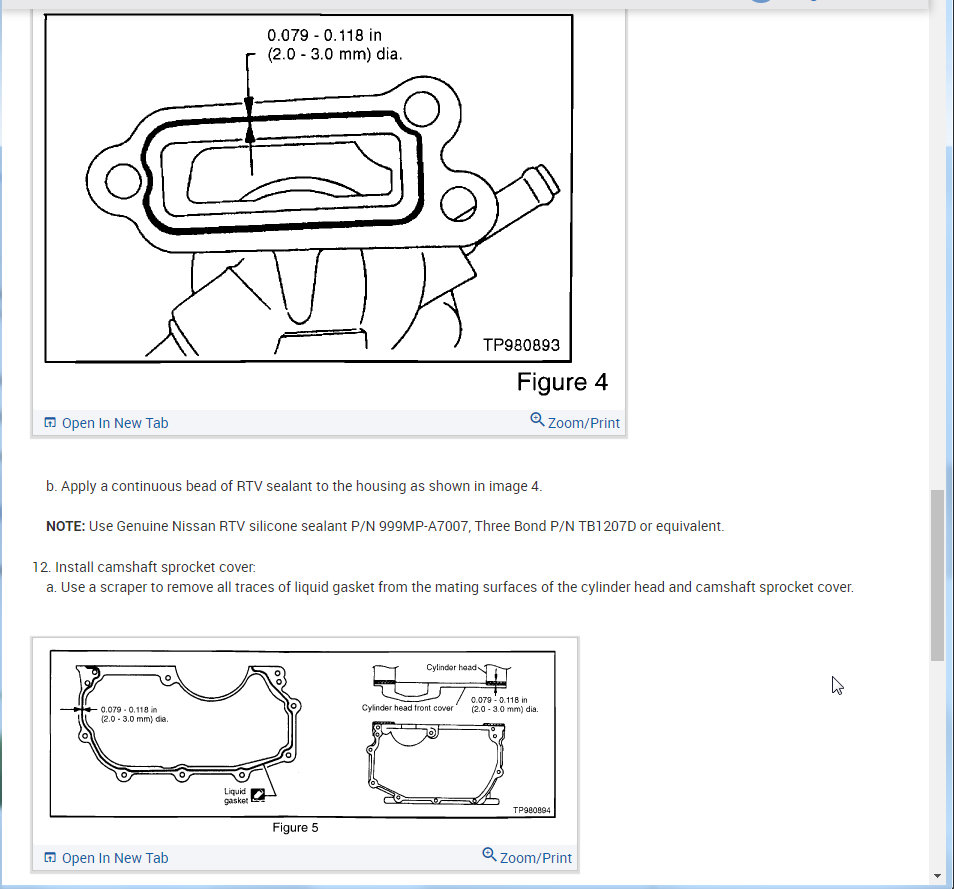

I am attaching the process for the timing chain that includes most everything you will need. If there is something more that you are looking for, let us know and we can provide that. Thanks
