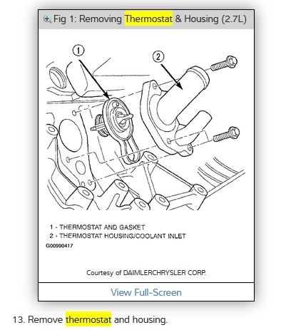

Hello, I am looking for the location for the thermostat.
Thank you.
Jun 10, 2018 at 12:10 AM
HARRY P
  • 2,292 POSTS

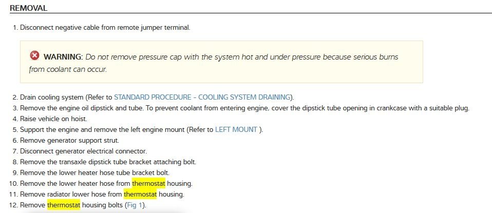

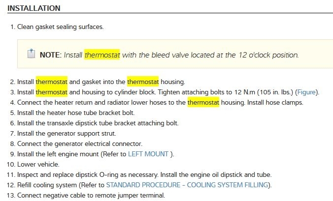

Prodemand does not simply list a location, but it does have a how-to article for the job. I have attached it in the images below. It may be the most complex thermostat job I have ever seen.
