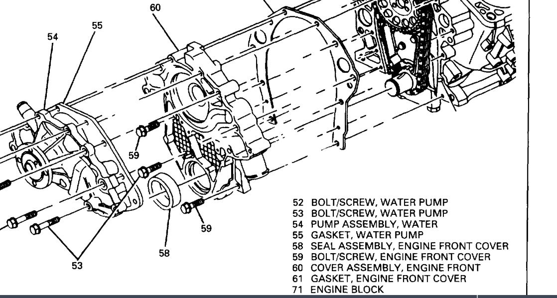

The procedure is to remove the pan but you do not. If you loosen the front bolts in the oil pan, it will move down enough to remove and install the cover. It is tight but can be done. I do it all the time.

That sounds good, thank you Roy. Your diagram clearly shows the gaskets for the water pump, the timing cover to block, and the crank seal, but what precautions do I need to take when I put it back together to make sure I do not get an oil leak from the oil pan or from the oil pan/timing cover joint? When I separate them (even if I am careful), am I likely to tear the oil pan gasket? Is there a gasket or seal I should replace between the the pan and cover or do they just butt together? Just apply RTV?

The oil pan gasket is a thick rubber gasket, not a paper gasket. put some gray sealer on the bottom of the timing cover when installing.
clean all the surfaces well and make sure they are clean. a small amount of RTV is good.
