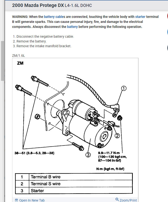

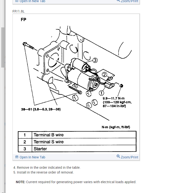

This is a multiple part question. Is there a schematic for removal/installation for the starter ? Is it worth it to buy a re-manufactured or a brand new starter ? Is it easy to access the screws that hold the starter to the bellhousing ?
I've already inspected the starter visually to see difficulty level of removing and installing a new one. Sometimes (mostly in colder weather) I go to start/rotate the motor, and it will click with no starting, which i try again and then it starts. Scenario #2 is go to turn the motor over and it will chug a little then start.
