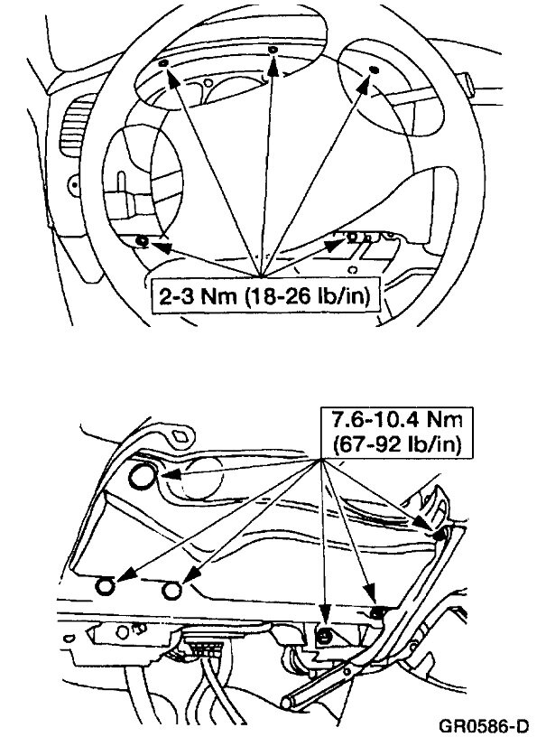

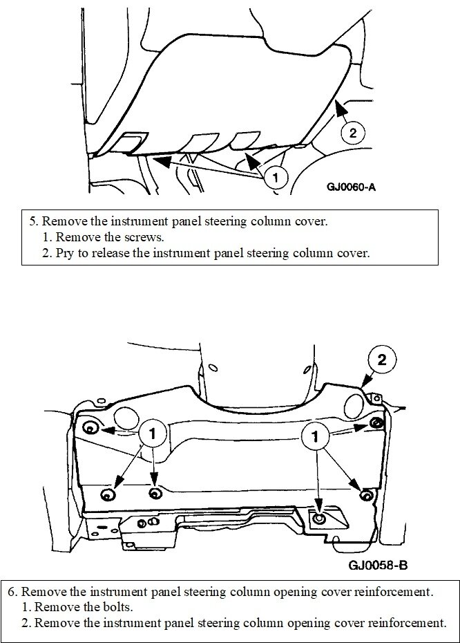

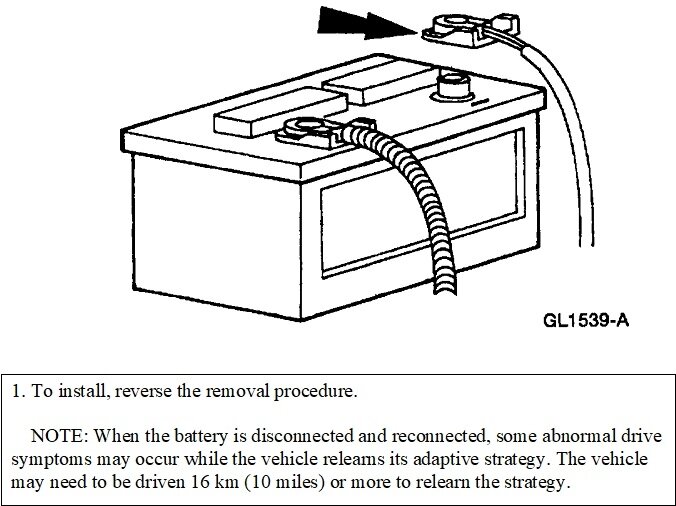

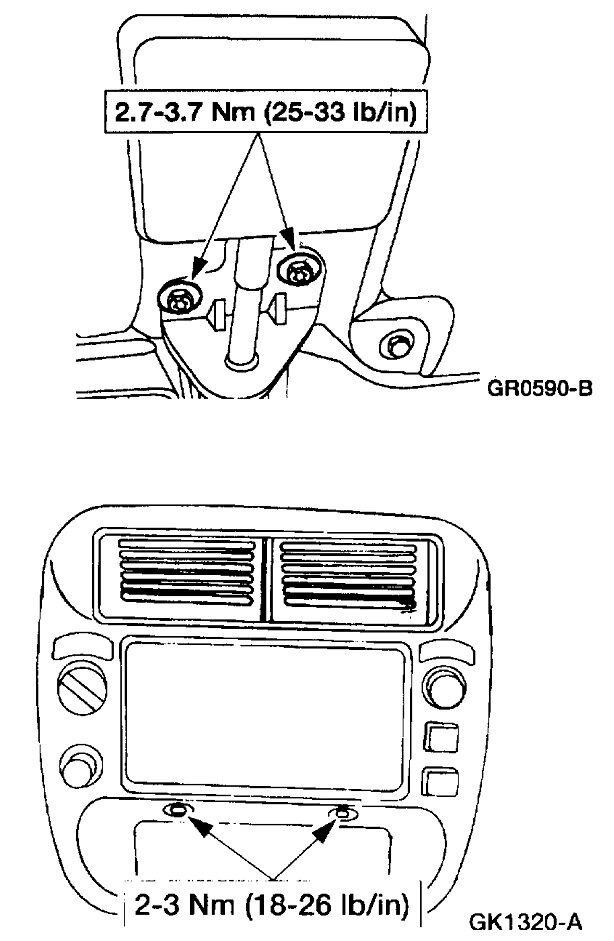

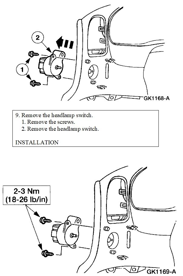

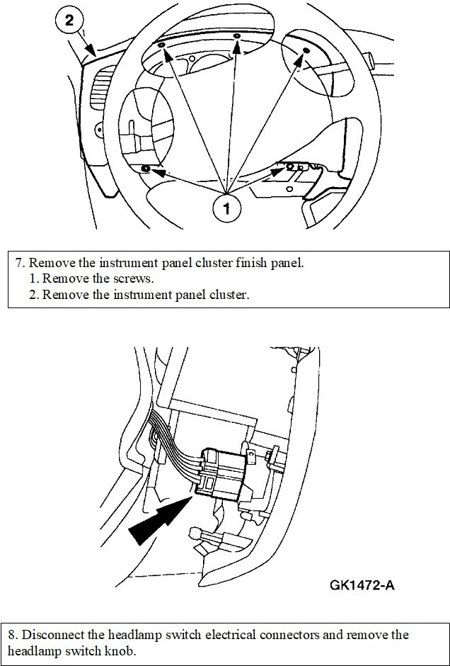

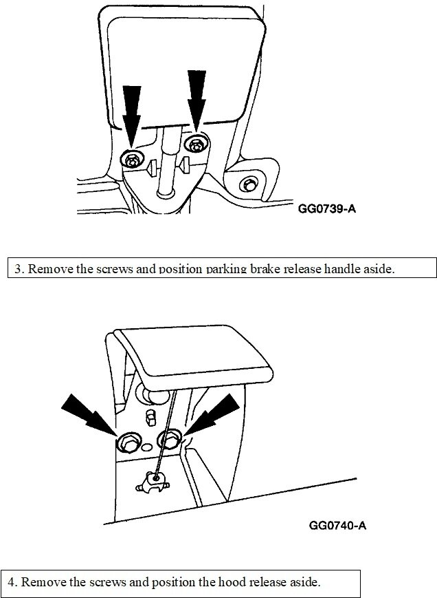

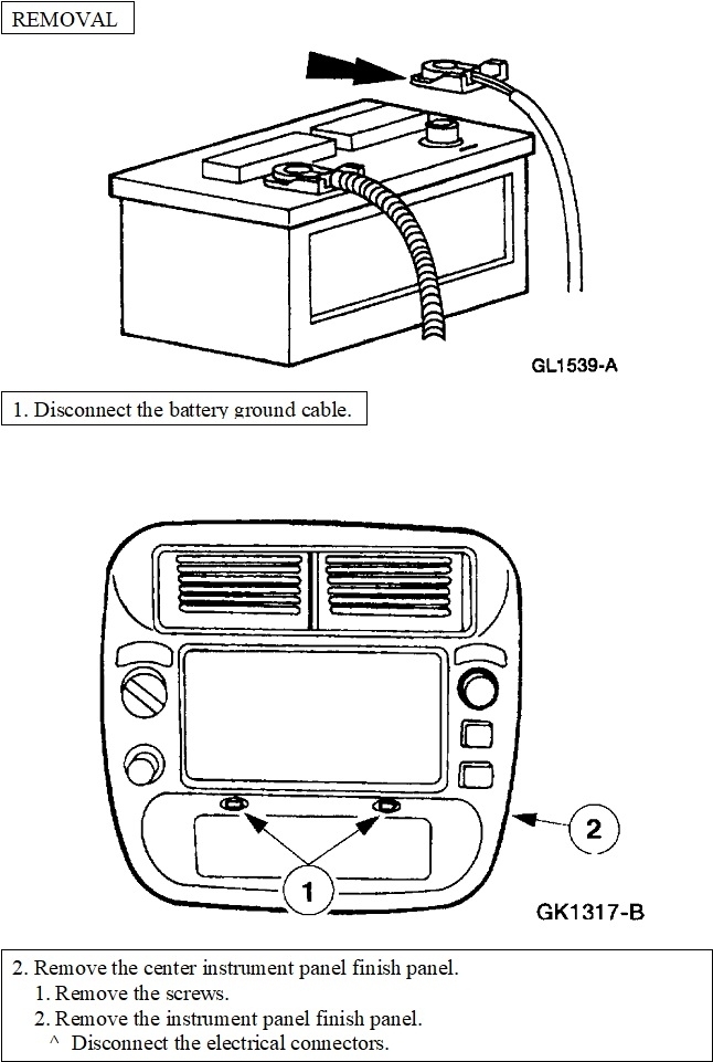

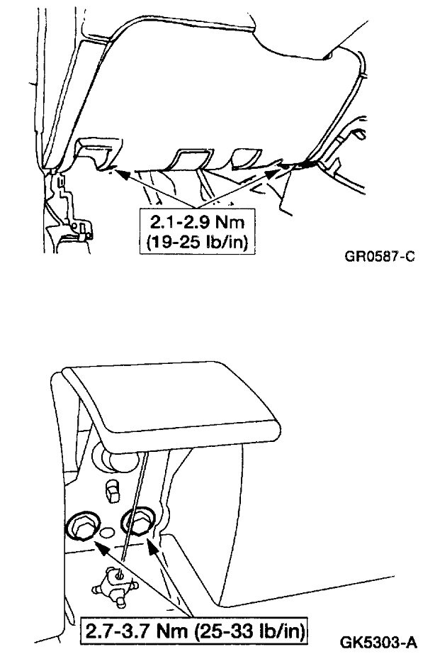

The engineers put a lot of effort into making this as difficult and complicated as possible. The procedure to replace the head lamp switch is shown below.
