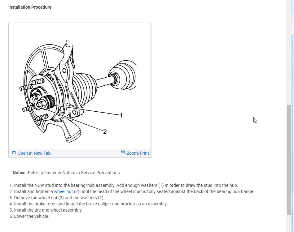

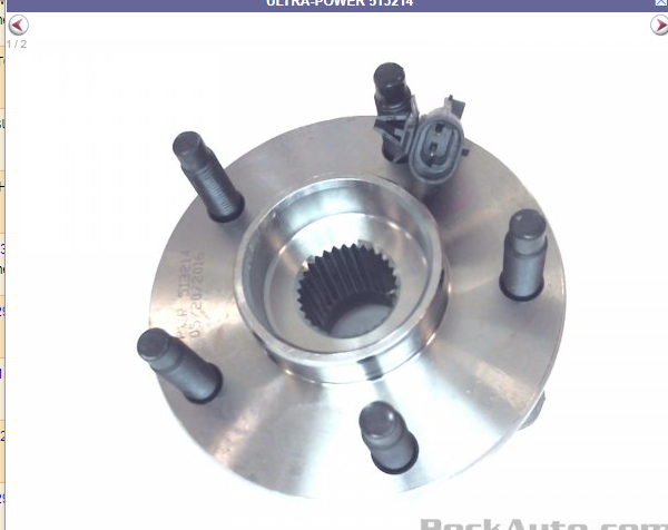

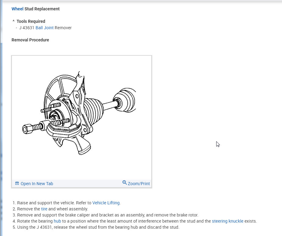

I attached the process but also a picture of a new hub. It comes with the studs installed on it already and I see they are only about $30.00. So by the time you buy the studs and replace them it may be worth the extra couple dollars to just replace the hub. It is much easier to just replace the hub which is why I am saying that.
However, the process for the studs is attached as well.
