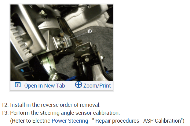

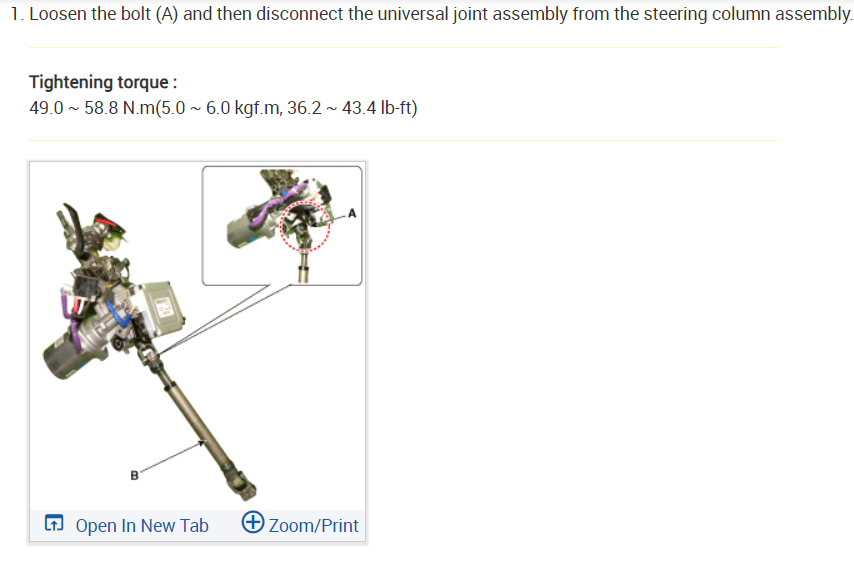

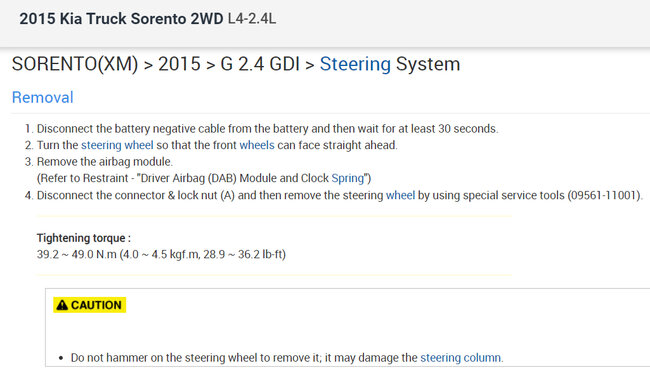

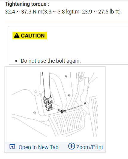

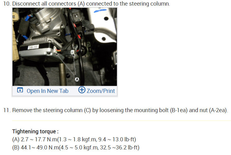

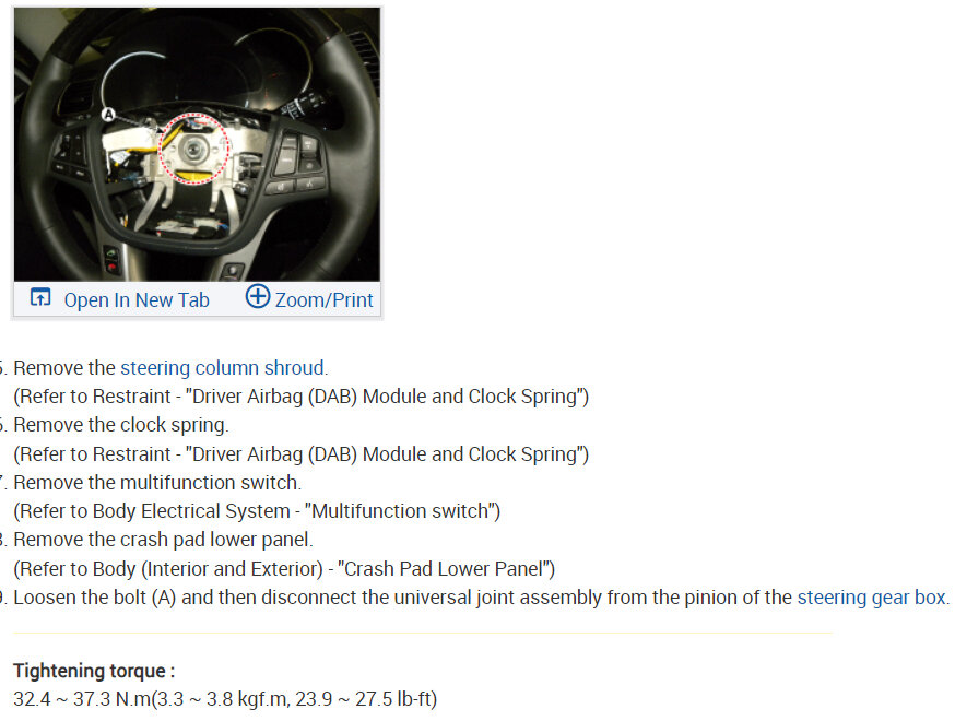

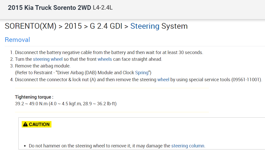

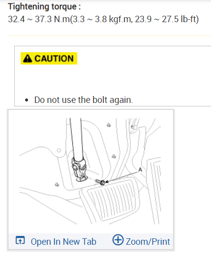

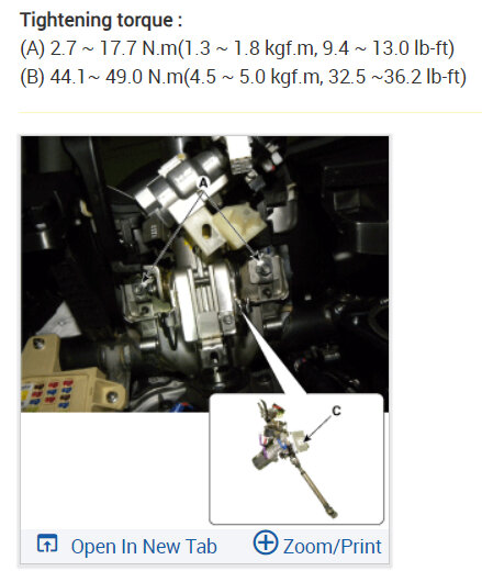

So, this is electric power steering, I would make sure the front wheels are straight and then make sure the steering wheel is centered and then it should go together on the spline correctly. Do not spin the steering wheel because you will break the spiral wire (clock spring) Here is how to install the steering column and intermediate shaft. Check out the images (below). Let us know how it goes.
