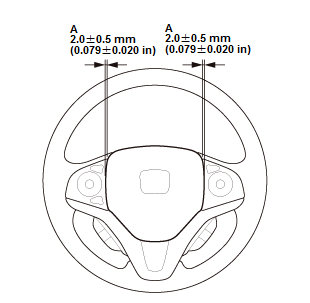

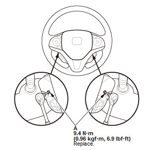

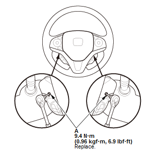

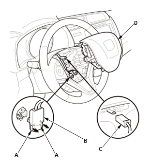

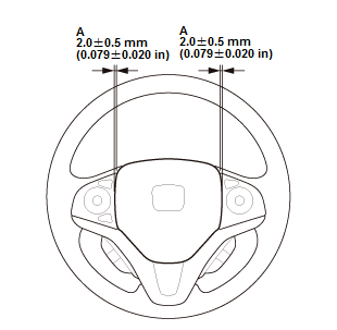

If nothing has been deployed, here are the directions for replacement. The attached pictures correlate with the directions.

2. Driver's Airbag - Remove
Pic 1
1. Remove the TORX bolts (A) using a TORX T30 bit.
Pic 2
2. Pull up on both locking tabs (A) to disconnect the connectors (B).
NOTE: Be careful not to damage the connectors.
3. Disconnect the connector (C).
4. Remove the driver's airbag (D).
NOTE: If you are replacing a deployed driver's airbag, inspect the cable reel for heat damage. If there is any damage, replace the cable reel (CLICK HERE).
3. All Removed Parts - Install
Pic 3
1. Install the all removed parts in the reverse order of removal.
NOTE:
• During installation, install the new TORX bolts to the specified torque.
• Make sure the clearance (A) between the steering wheel and horn pad is the specified value.
• After connecting the negative cable to the 12 volt battery, make sure the horn works properly.
