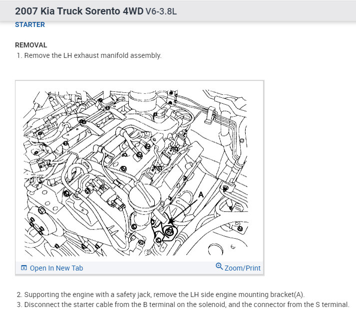

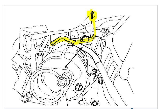

If it is the transmission dipstick tube that is the issue, there is a bolt holding it in place behind the catalytic converter. See pic 1.

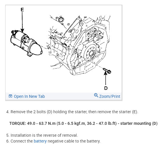

However, the directions indicate the engine needs to be lowered for the removal of the starter motor.
I attached the directions I have below. Take a look and let me know if this helps or if you have other questions.
joe
See pics below.

Chances are you won't get the manifold out. I have no idea why people design things like this.
As far as I know, the engine needs to be lowered. However, anything is possible. As far as lowering the engine, it sounds like a nightmare, but it's not as bad as you would think. You don't need the tool that is listed. You could use a floor jack to gently lower it once the mount is unbolted.
Let me know if you have questions and if I can help.
