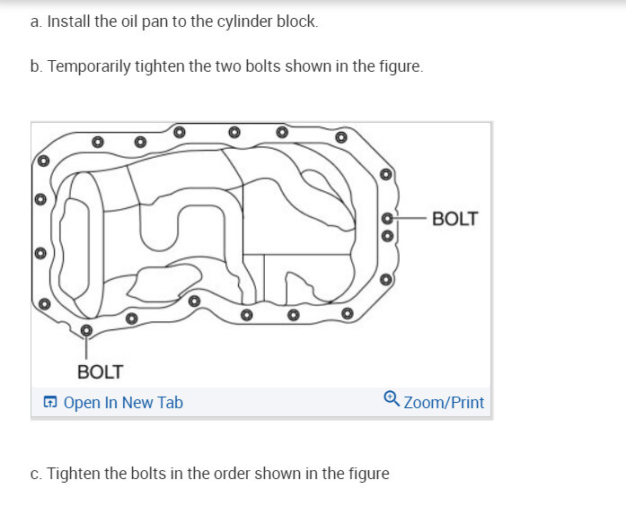

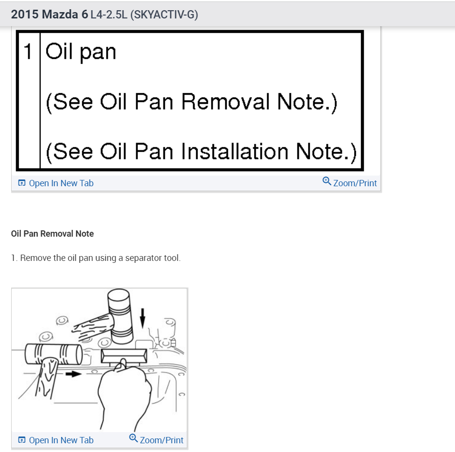

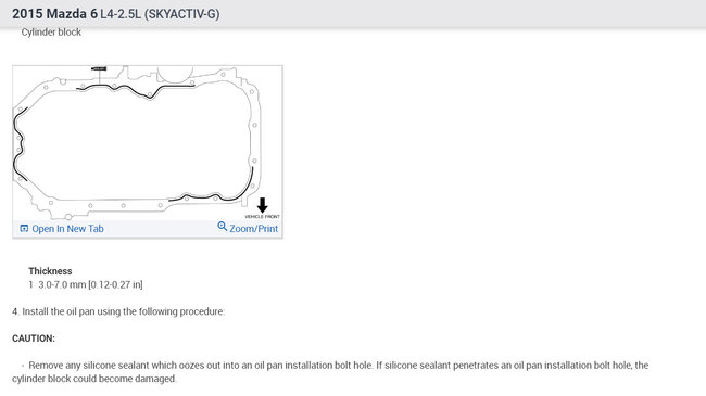

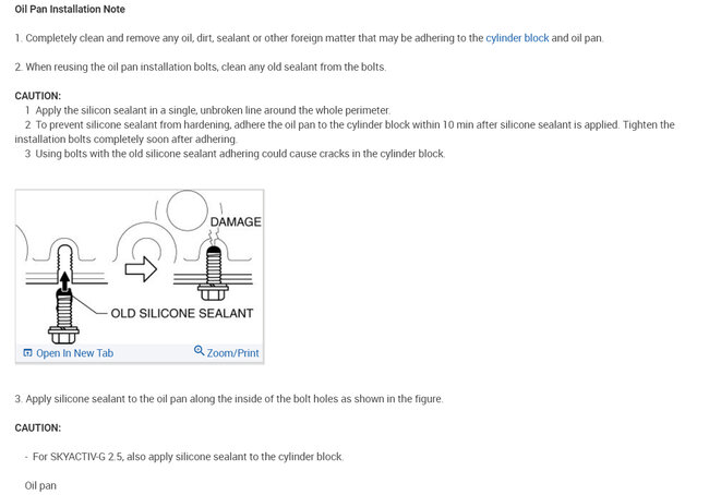

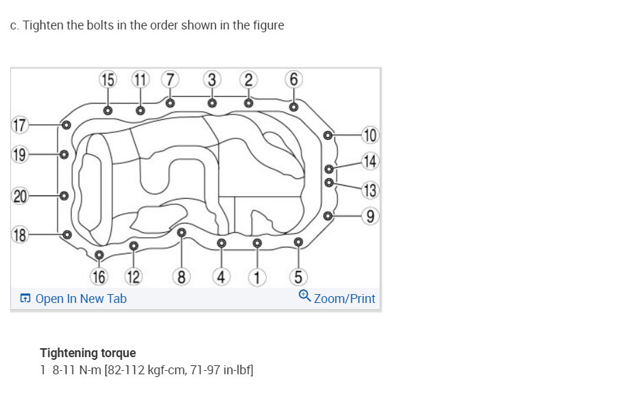

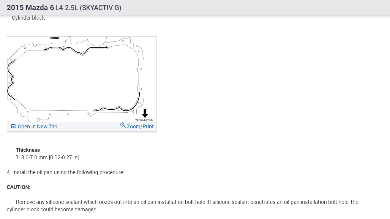

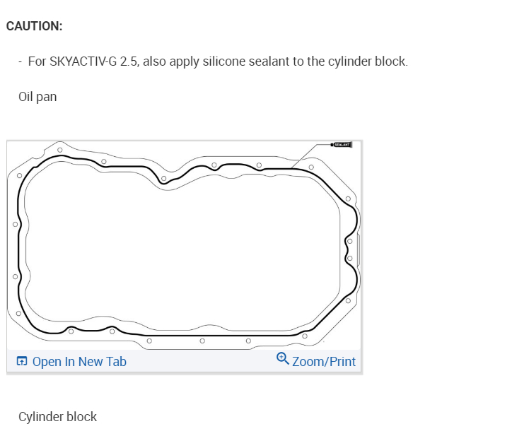

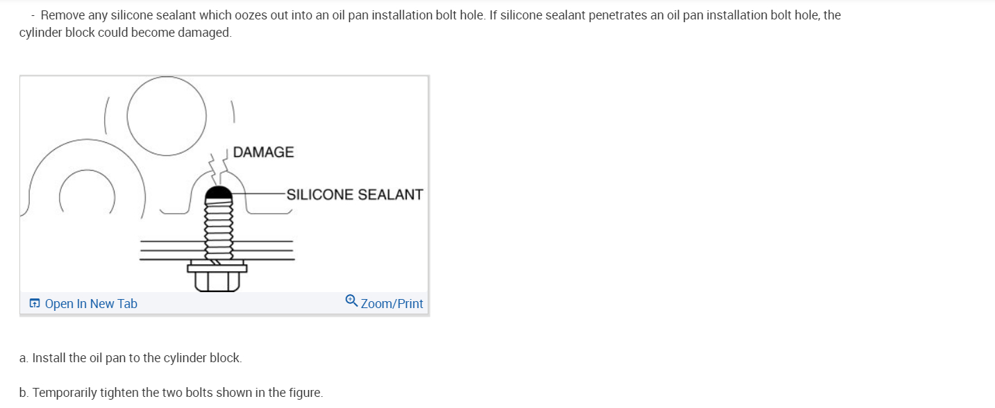

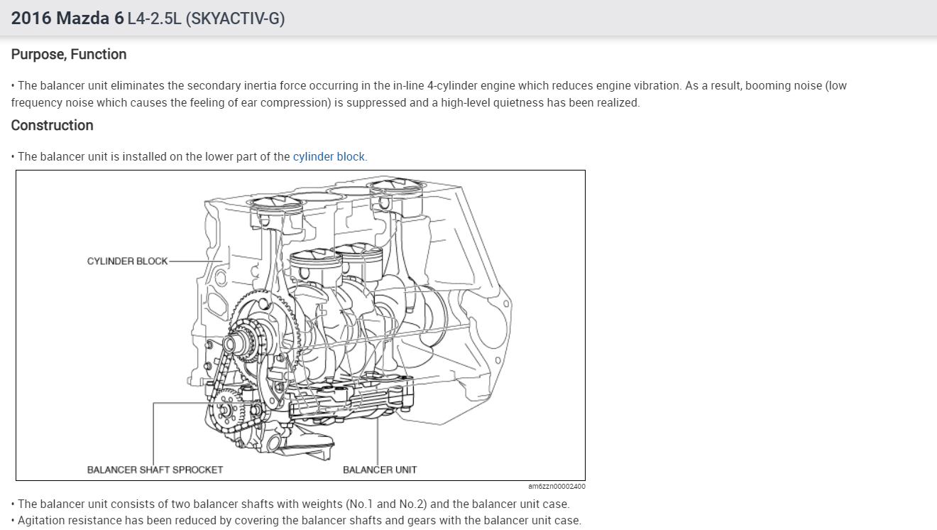

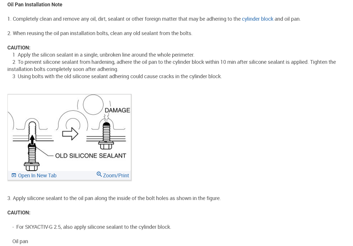

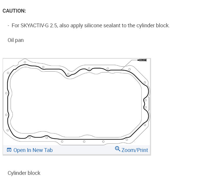

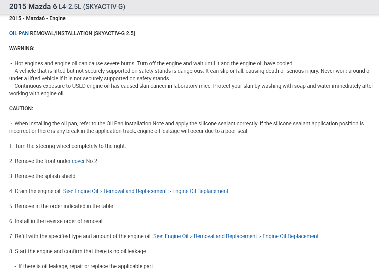

It is not too bad to do the rod bearing. You will need to remove the oil pan first, which I have included the instructions for in the images below.
for the SkyActiv-G 2.5L engine commonly found in the 2015 Mazda 6, the connecting rod bolt torque is typically around 33-38 lb-ft (45-52 Nm)
Check out the images (below). Let us know what happens and please upload pictures or videos of the problem so we can see what's going on.

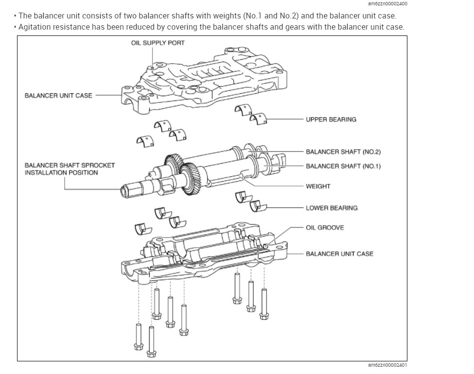

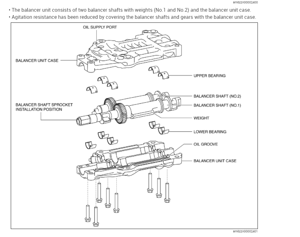

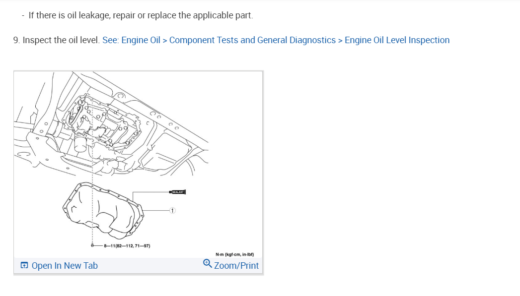

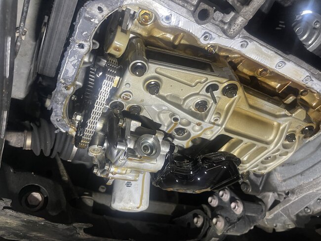

Not as simple as I thought it would be. I thought i would be able to see the bearings from below. Geez
Image (Click to enlarge)
May 20, 2023 at 8:37 AM
CERTIFIED EXPERT
53,854 POSTS
That is the balance shaft assembly. Here are the instructions on how to remove it. Check out the images (below). Please let us know what happens.
May 21, 2023 at 11:32 AM
BHAMDOC1973
MEMBER
2,008 POSTS
Yes, i don't want to fool with chains. I'll get another motor.
