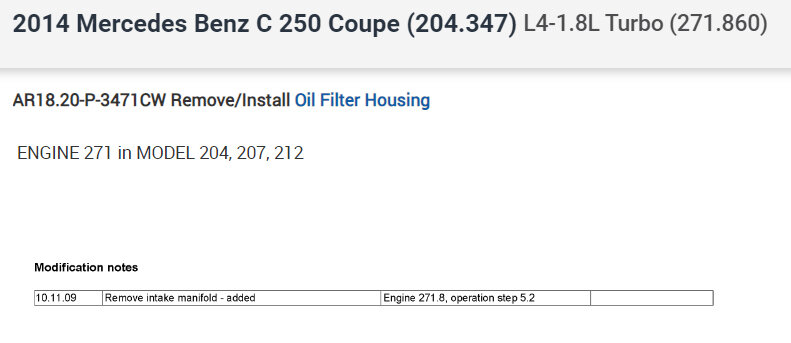

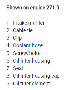

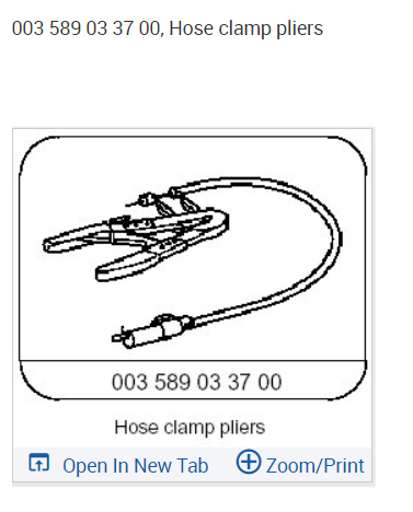

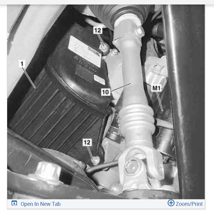

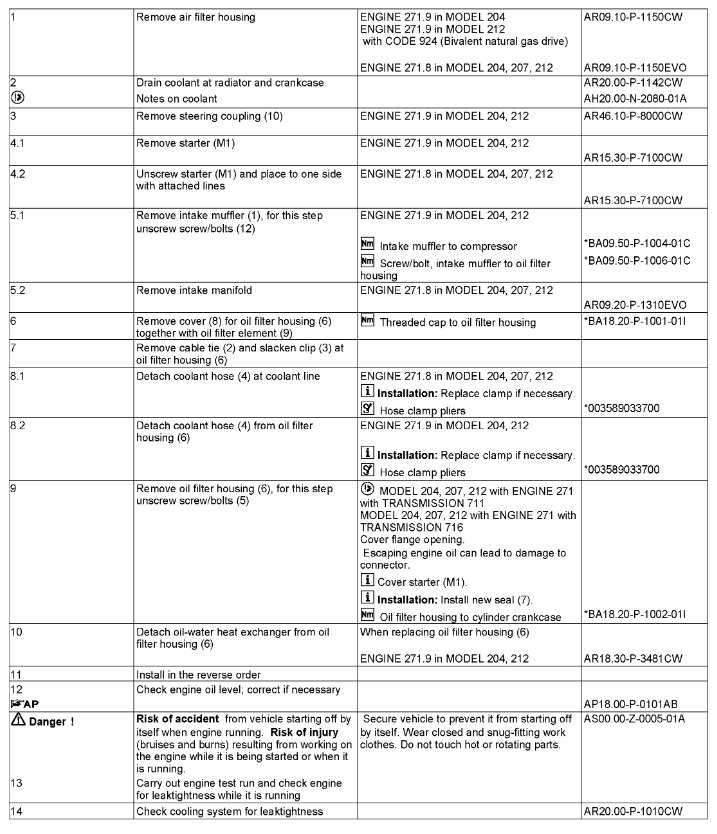

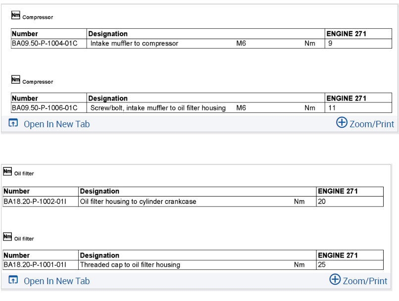

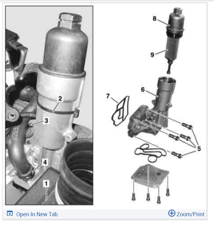

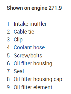

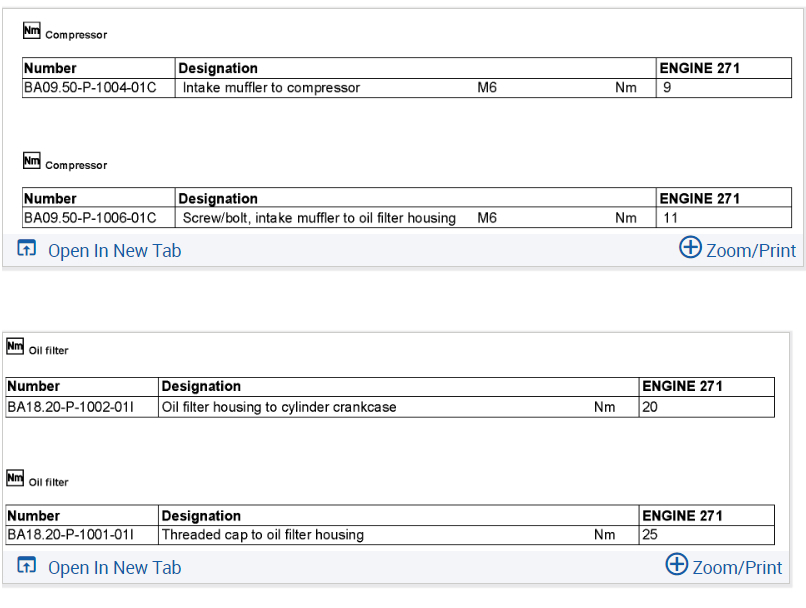

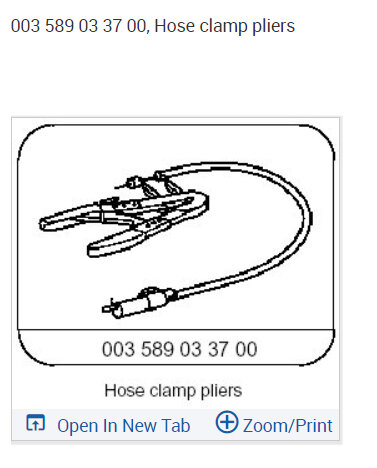

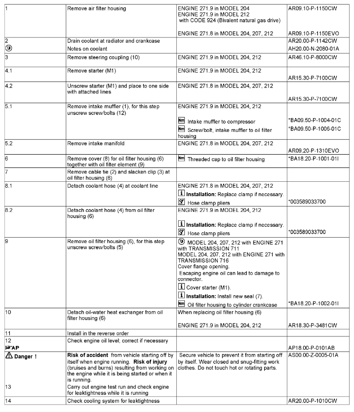

No problem, we can help you, but you didn't mention that the oil plug drain seal was replaced as well. This is a large source of oil leakage. Here are the instructions on how to replace the oil filter housing and seals which do leak as well. I am sorry for your trouble, but we are here to help, for free. Check out the images (below). Please upload pictures or videos in your response to the problem so we can see what's going on.
