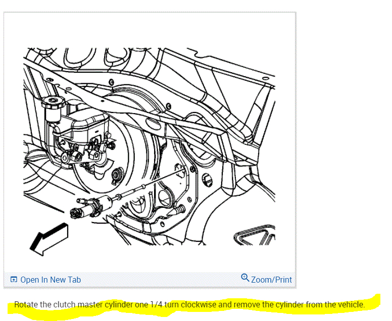

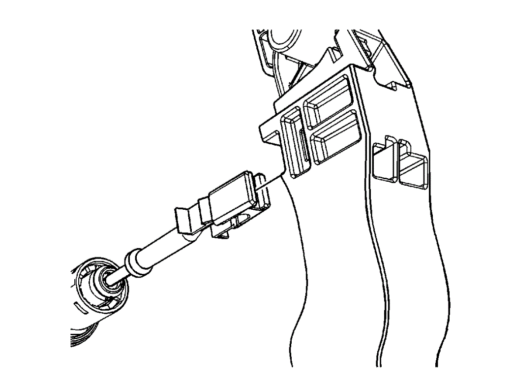

There is a retainer clip that holds the pushrod to the pedal. See pic 1. To remove it, depress the forward-facing tabs and pull upward on the clutch pedal.
To remove the master cylinder from the fire wall, turn it 1/4 turn clockwise. See pic 2 below.
See pics below.

I got the pushrod out of the pedal, but the plastic is still behind it somewhat majority just one side of the taps is broken off but if I can get a shorter flat head on each side to depress. I may be able to get it out or just leave it in and place the new master clutch push rod in it?
Nov 20, 2021 at 10:28 AM
I'm trying to picture what you are saying. What plastic part is broken? If it is in the pedal, the new one won't fit.
