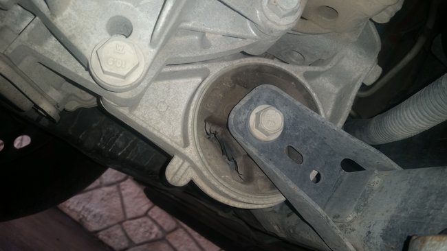

Does anyone know how to replace this lower front transmission mount? I cannot find any information about it on YouTube or Google. It seems like only the top mount is a common failure, but no information on how to do the bottom mount.

From looking at your dandy photo, it appears this should be self-explanatory once you have the new one in your hand to look at. The center bolt going through the rubber isolator will have to come out. The large silver bolt near the top left of the photo holds the mount to the engine, and it looks like there is a bolt in the front, near the top right of your photo.
