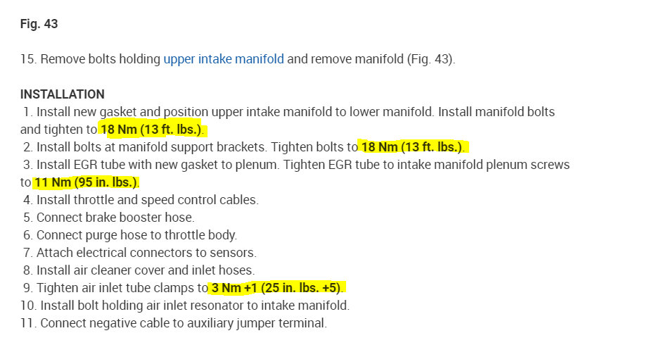

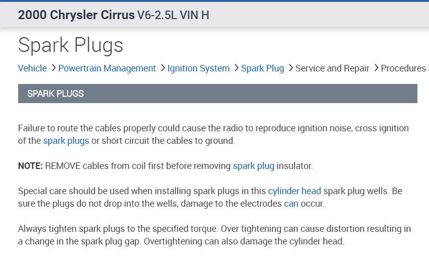

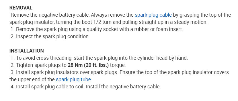

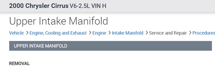

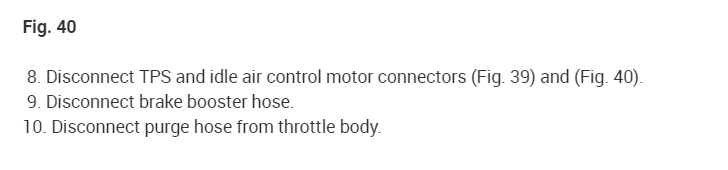

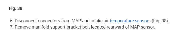

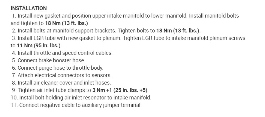

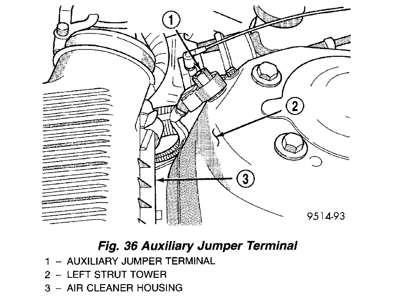

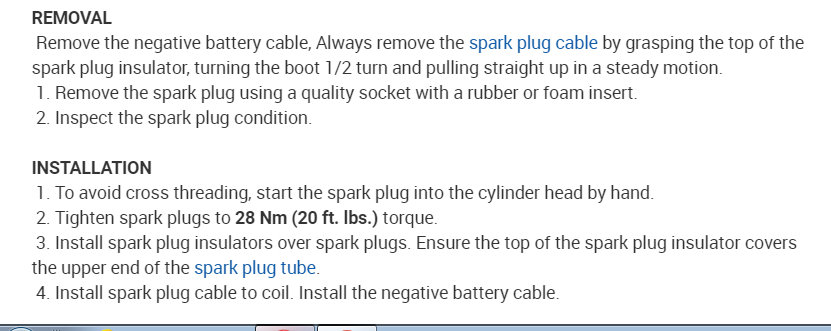

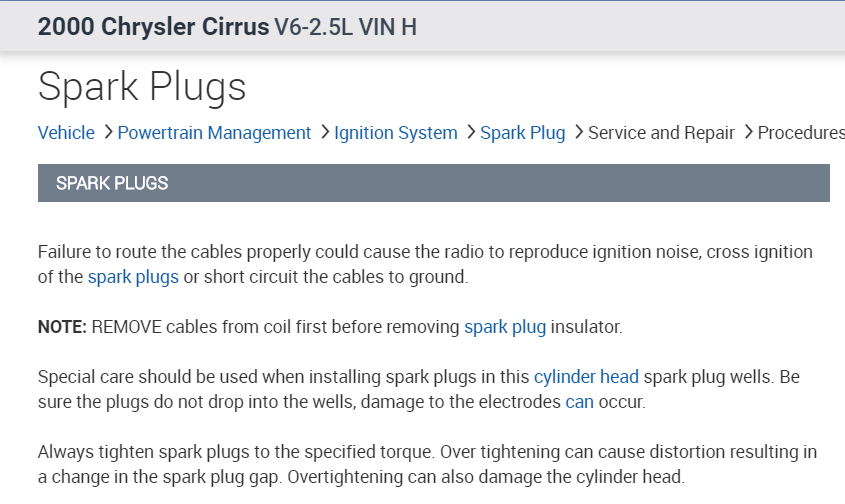

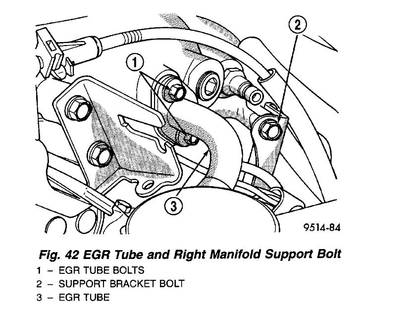

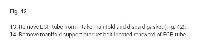

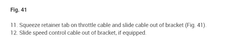

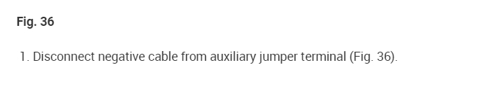

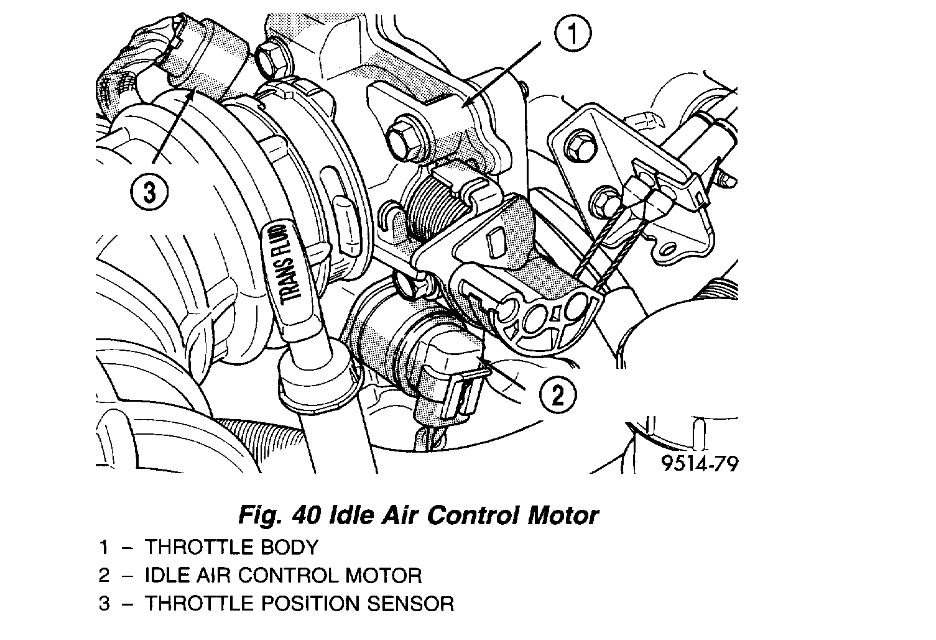

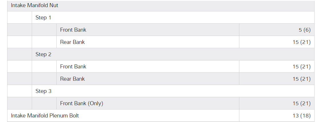

I am going to change my back three spark plugs I have to pull the intake manifold to do it. I need the torque specs and step-by-step directions on how to install my intake manifold after I replace the factory spark plugs.
