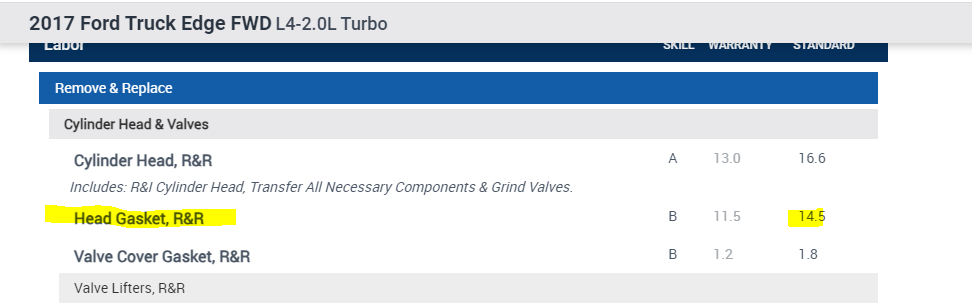

I'm not sure why the dealer would tell you the head gasket can't be replaced. I went through two manuals, and both provided directions and flat rate times for the repair. The labor is extensive, 14.5 hours. But that still wouldn't justify $3,500.00 to replace it. However, the shop rates where you are located may be different than here.
I attached the labor rates for you below.
Let me know what I can do to help.
See pic below.
