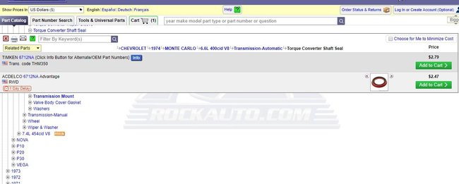

i have no problem. i just would like to know what oil seal you would recommend?
Aug 20, 2019 at 9:51 AM (Merged)
Good evening.
Either Timken or AC Delco. They are both good seals.
BROOKS BONNIWELL
Thank you very much. I will use your advice!
