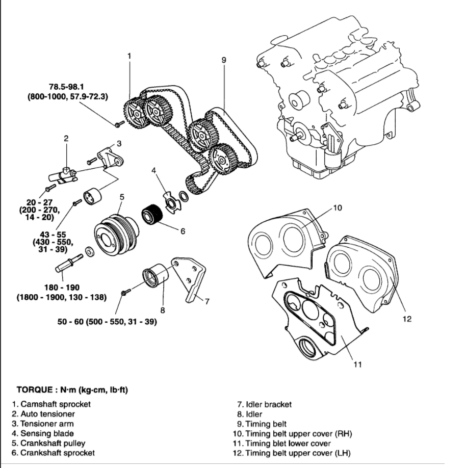

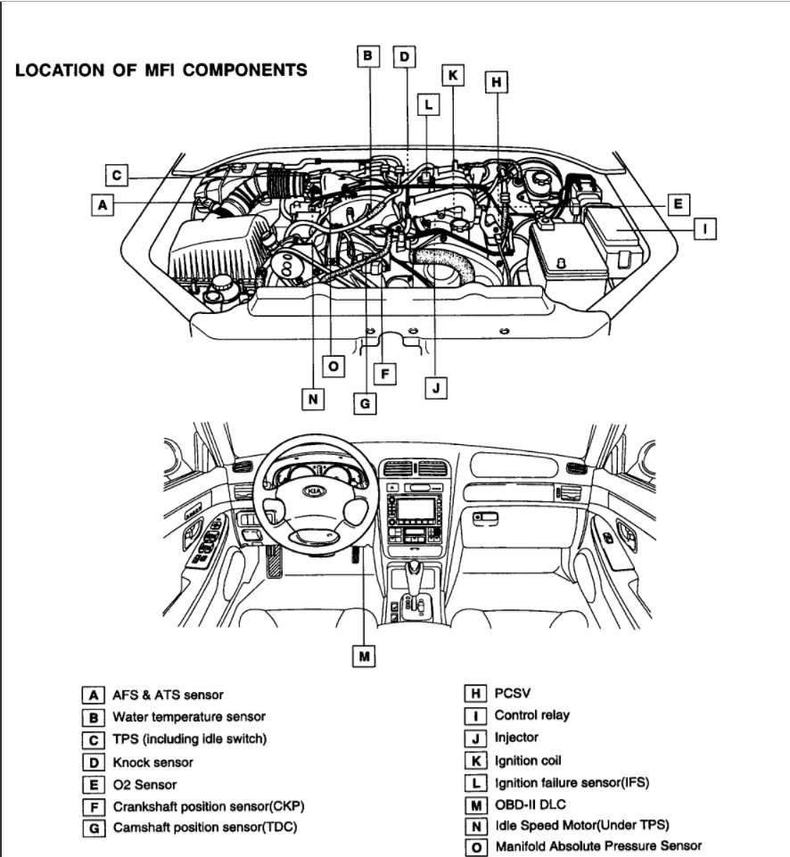

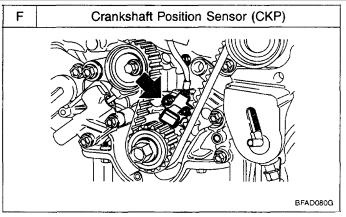

The sensor is behind the timing belt cover. Here is a guide to show you what you are in for when doing the job less the timing cover
Here are some diagrams (Below) that will help you get the job done.
