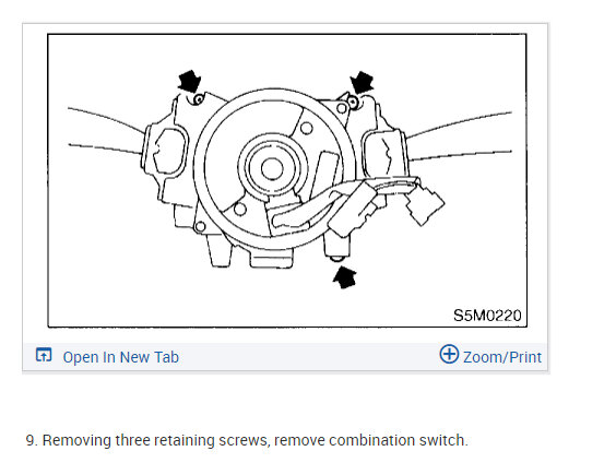

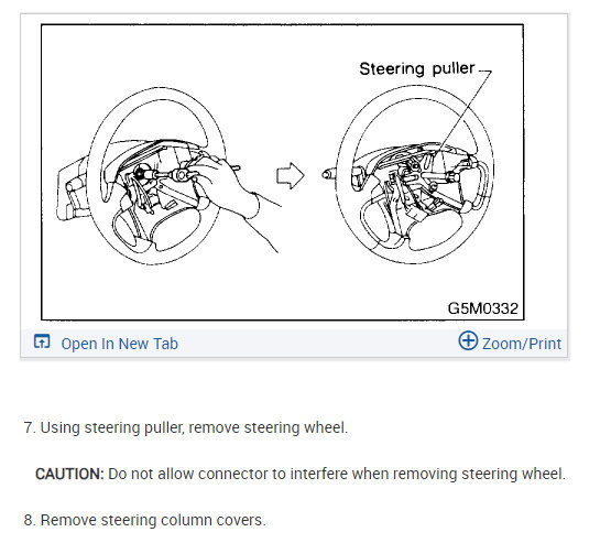

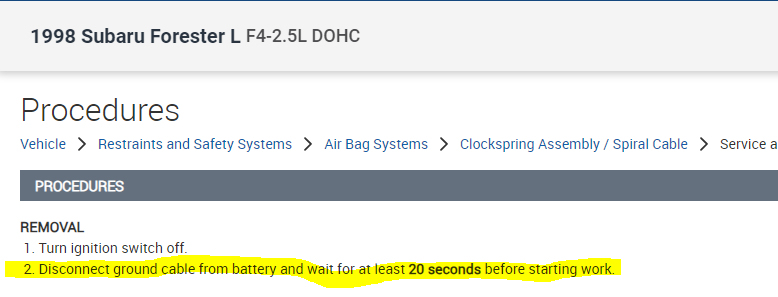

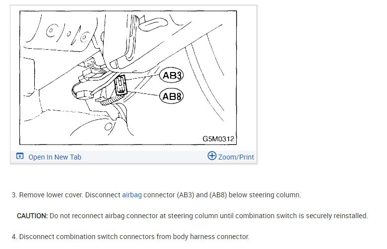

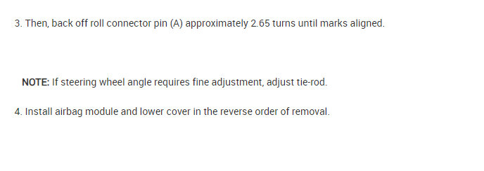

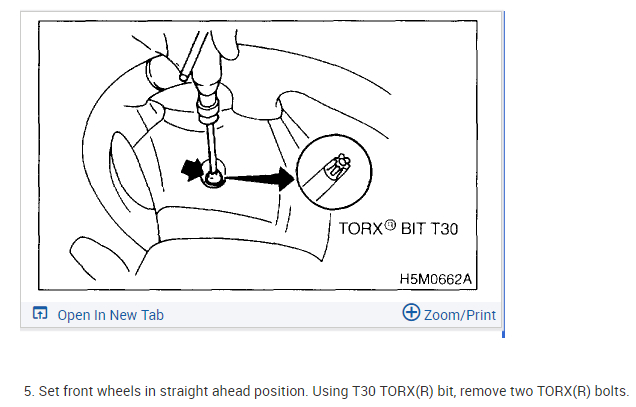

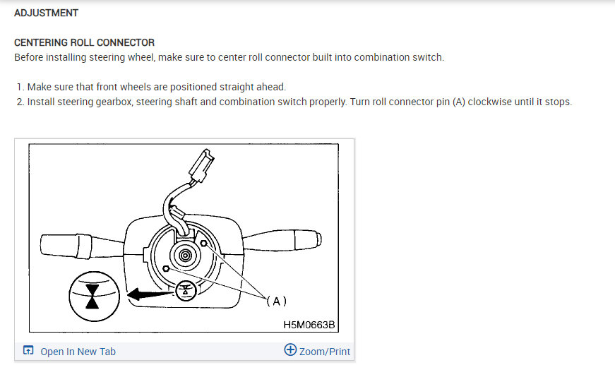

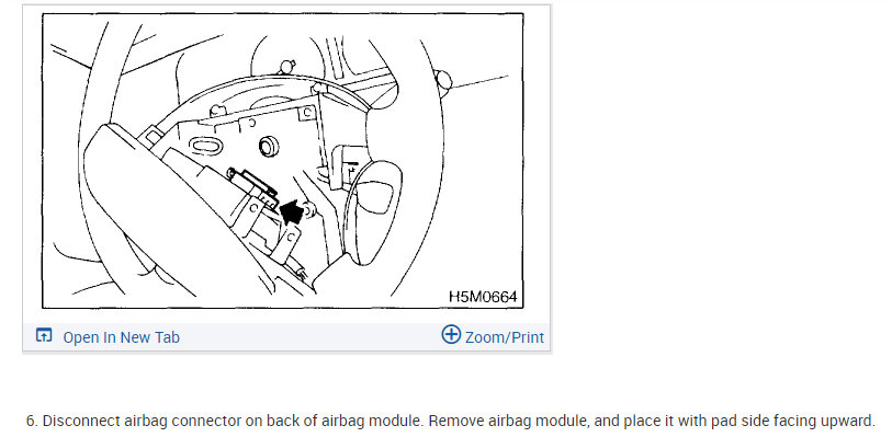

The clock spring should be replaced. You can't jump from the horn connector to the horn directly.
As far as the clock spring, you are better safe than sorry. However, I reviewed the directions, and the only requirement is to disconnect the negative battery cable at a minimum of 20 seconds. I would give it at least 10 minutes.
I attached the directions below. Take a look through them and let me know if they help or if you have questions.
See pics below.

Thanks, Joe! I've already downloaded lots of info and video on the procedure but thank you for the pics. As I said, my only concern is accidentally deploying that airbag while it's upside down on the steering column. I'll just have to decide whether I feel comfortable enough to attempt it myself.
Aug 15, 2024 at 8:00 AM
Once the power is removed, it should be okay to deal with. If you are still concerned, remove the fuse for the air bag system as well.
Let me know if I can help.
